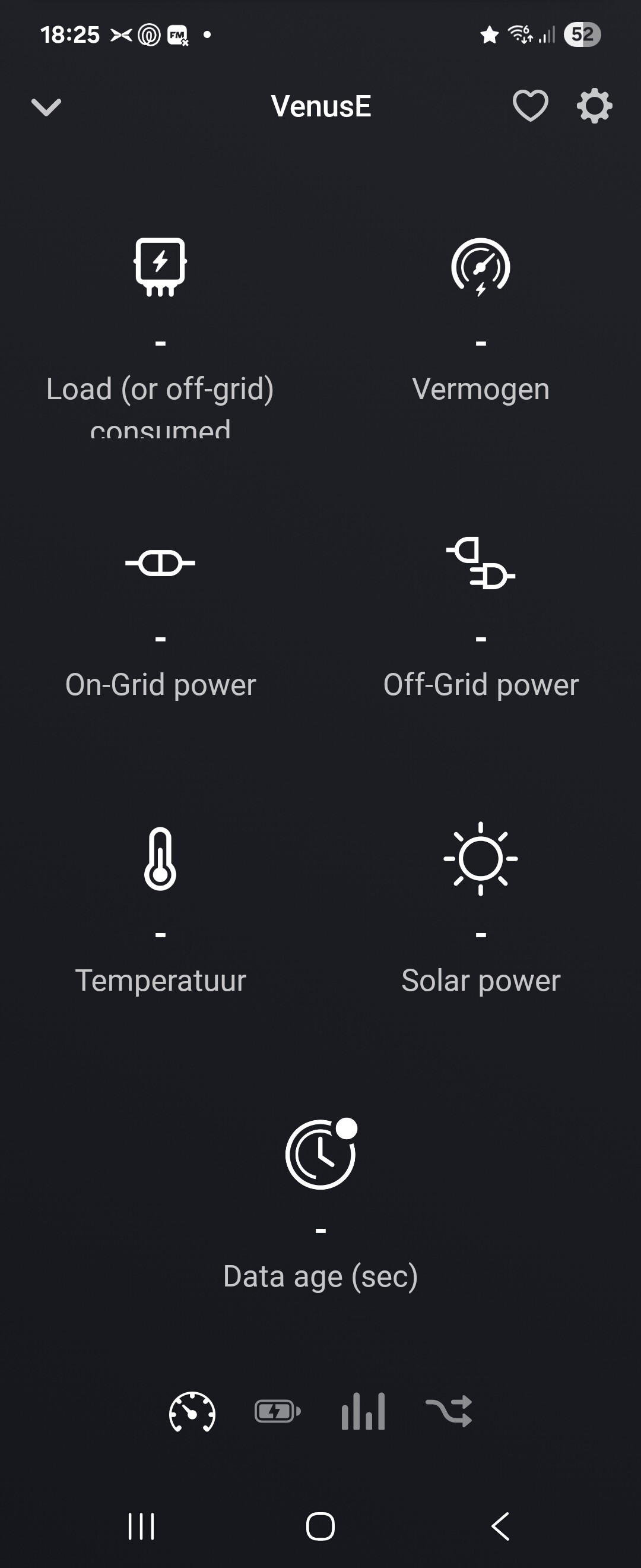

hi @eniewold ,
Nice work so far on the app, I like the approach since I am not very technical to use MQTT etc. I have 3 Marstek venus 3 v2, V153, comm module 159 and V117 for the CT003 P1 meter. All is on the same 2.4Ghz only wifi, good connections and fixed ip’s.
I setup 1 Venus with Local API (port 30000) and it was added to my Homey Pro as a device. Just started with a simple workflow: if it is a specific time and the battery level is below 20% than set the operation mode to AI.
I received an error: timeout after 60000 ms for the step set to operation mode. And a general warning about the battery level :warning: (only in red)
Did I do something wrong or is this the known connection issue (when local API is enabled)?
Thanks
Unfortunately the Marstek battery does not like to share local API communication with CT00x and Homey. I’m hoping this can be solved, or that I can find a workaround, but this is probably something at Marstek side.
