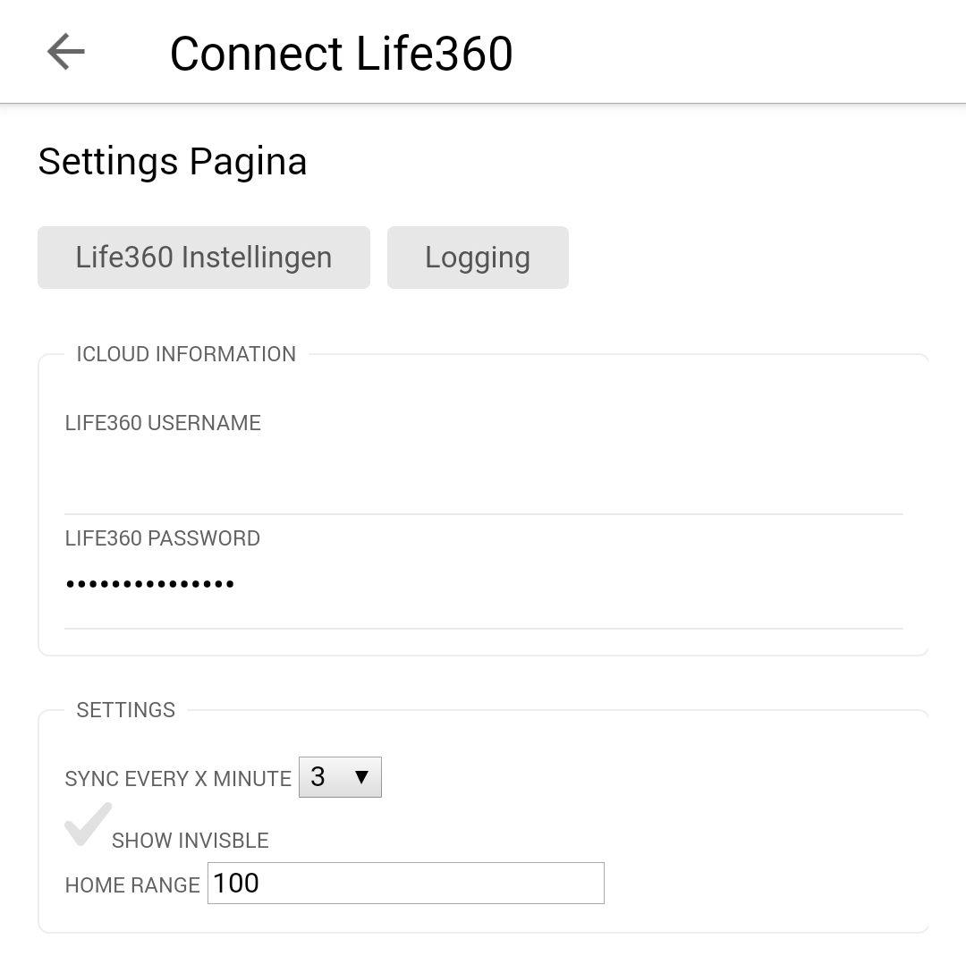

Hi there! I just installed the Life360 app. I have a Circle and it works just fine on our Android mobiles. Now I want to add it on my Homey. I installed the app and need to configure. When I use my credentials which I use for the app and also works when I login on their website… it doesn’t work in Homey…What to do next?
I received this error:
Error: timeout is not defined
I couldn’t find a solution in all 158 comments, hope someone can help me :+1:
I also have the timeout issue , been running 360 app for a year , no major issues but this time the workaround changing a setting does not work.
Im also having the timeout issue, anyone here that can help?
Impossible for me to connect also … canI ask you to clearly explain how to connect to the application ?
Do I need to configure a user name and password first as I did ?
Do I need to change some settings ?
I have many error messages : timeout - not authorized…
Thanks in advanced for your support …
This application seems to be very helpfull
First make sure your life360 app is working on your phone. Then install the life360 app on home and fill in your email address and pw in settings of the homey life360 app. Check the logging if everything went fine.
