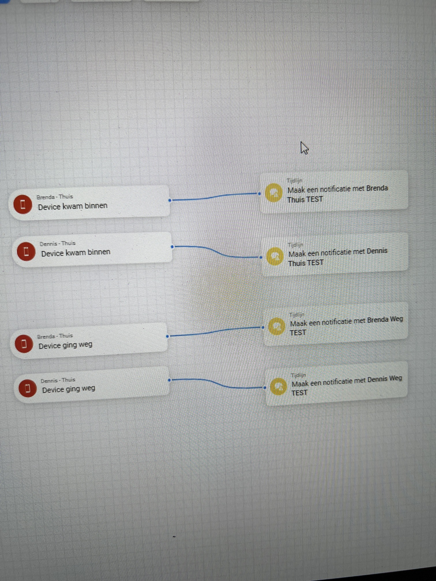

Take a look at the range of your own custom place and you can enter it here
Yes i know … i did change to 600m yesterday … still has the issue ( worked for years on 300 m with nonissue at all )
I only wanted to confirm what you stated … the range did not update ( 1.3 meters fir 2 hours ) … but the place was updated when the issue happend ( 3 mins ago )
Screenshot_20230914_160726_Chrome
In my opinion these cards only influence this… so I use them now
:joy: made the same as a test 2 5 mins ago
