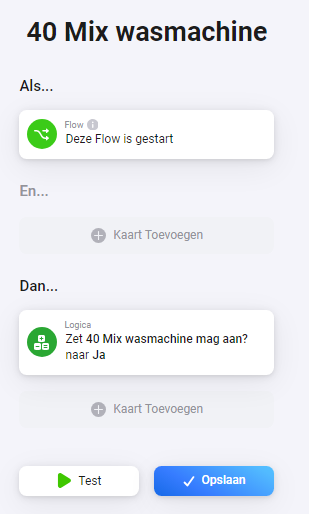

Voor de geïnteresseerden, hier mijn totale flow, inclusief check op lage energietarieven.
Ik werk met een variabele die ik met een simpele flow op Ja zet, middels een knop op onze telefoons. Dit doen we ook voor de vaatwasser.

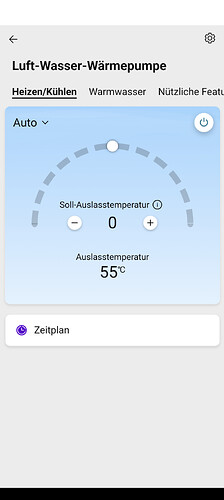

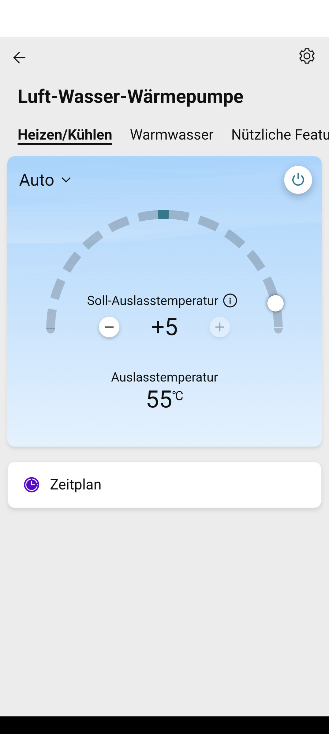

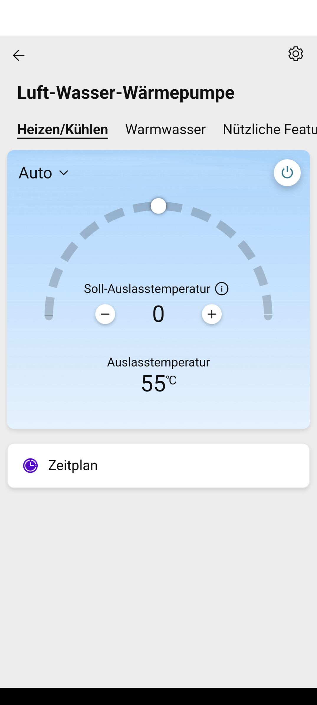

I have remarks/questions regarding management of my AWHP:
My AWHP runs in AI-Mode. When I want to change the temperature, I don’t set a temperature in the LG Android app, but a value from -5 to +5 (see screenshots).

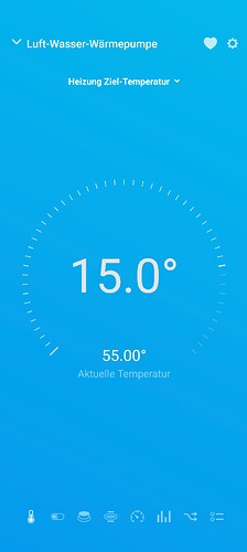

The homey app unfortunately only shows degrees, also while AWHP runs in AI-Mode. With flow actions I can change temperature only by setting a degree - which however doesn’t reflect how I set values in the LG app in Android (values from -5 to 5).
I tested and realized following: when I set the temperature in the homey app (in ui or thru flow action) eg to 18 degrees, then the value in the android app is set to +1. This means for one degree plus in the homey app, the android app value is changed +1 as well. So I got following value mapping:

As a result I have a workaround. But there is a limitation! In the homey app I can set 15 degrees as lowest possible value. Lower values, even thru a flow action, are ignored. So this means I can reduce the heat only to -2, not -5, in the homey app.
Would it be possible to change this restriction, so I can use the workaround?
