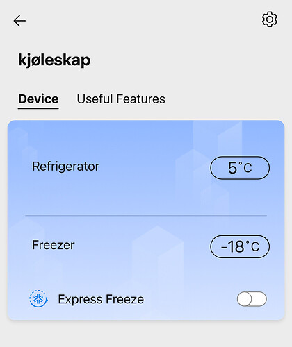

Hi. I have a LG refrigerator. I Can add it to the LG Homey app, But no information about temperatur, or i Can not set any new temperatur. Still it work in the lg app. See the second picture. So this Homey app is not working for me:( hope it Can come a fix asap?
This is from the LG ThinQ app… there its work, and i Can set new temperatur and its live on refrigerator in the second i change …
I see you submitted a diagnostic report. Thanks! I noticed it is trying to set some values i did not see before. Will chec that out.
Thanks for your replay, if you need some more information or test. Let me know, i Can test in real time Also:)

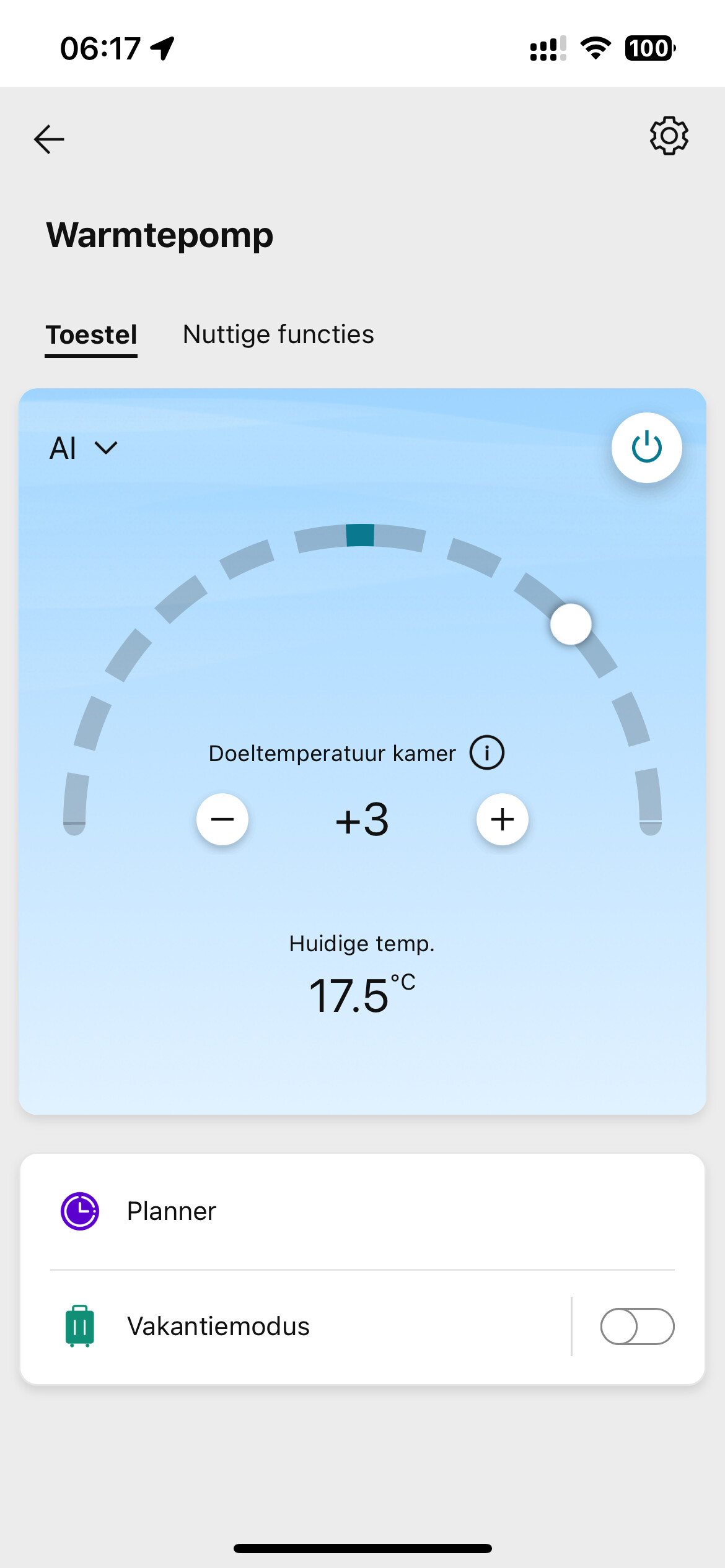

Dit is hoe het er uit ziet in de LG app, mocht je meer info nodig hebben hoor ik het!
Tevens kon je als je de wp toevoegt als airco de temp ook onder de 16c krijgen nu is 16 bij de wp min temperatuur
