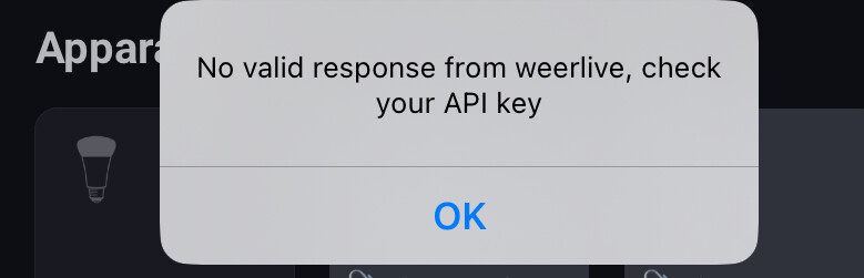

Can anyone help me out, I can’t get the app/api to work anymore.
Last data I received is 10-12 days ago.
I removed the device, tried to add new device but I keep getting the message: “No valid response from weerlive, check your api key.”
I tried:
  • adding the api key again
  • restarting app
  • restarting homey
  • removing app and installing it again
  • making a new account on weer live (although old account ‘made 0 requests today’)
But I keep getting the same error message. Anyone any ideas?
From what you describe, I think you’d inform with Weerlive if there’s any API issues.
Hi ArtjeB
Same problem here, How does this manual-update-flow look like? I have a flow every 8 minutes “KNMI - haal nieuwe data” but does not help to update all the expected parameters.
