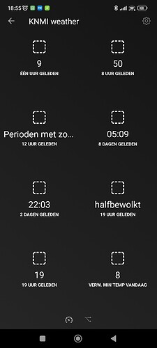

Not sure which parameters should be updated after restart of the app, but here the result
Before
After
I do not believe these screenshots help. Parameter such as sunup do not change every day, neither the wind force / “windkracht”. But as stated earlier I have seen the behaviour not updating the “max temp today” before.
If the max temp today of yesterday is the same temperature as yesterday, then it will not show as updated, that is normal and expected behavior.
If it should have updated due to actually changed data but it does not, then you can try and restart the app to trigger a new updating of values, do they then get updated or does the problem persist after an app restart?
I will check if restarting helps when this occurs again. But upto now it seems rather random behavior to me.
Understood that a value needs to change in order to “update” the value. That’s also why I am saying that the provided screenshots will not help.
