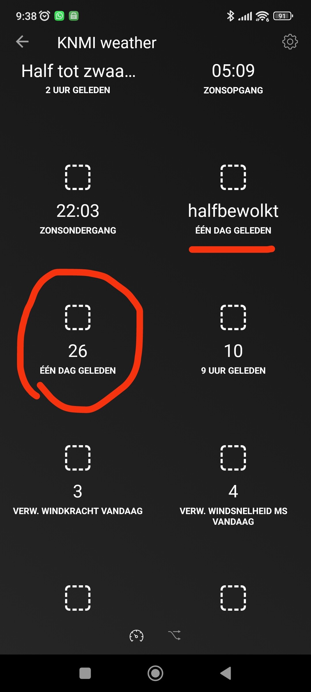

Knmi app is not updating correctly recently.
Especially the expected numbers are off.
Expected temp for today is 28 for example but last updated yesterday . Today max should be 17
“Zonsopkomst” updated 7 days ago
CURRENT values are updating without a problem.
I see the same issue. Have had it a few times before.
So I have added knmi as a device. Some parameters are updates, some are not. Doing a manual pull of data using the same API and location gives different data (so parameters changed but are not visible in knmi device)
Below a picture of the device parameters e.g. max temp today, d0tmax in the web pull.
Update: a manual update in a flow does update all parameters.
