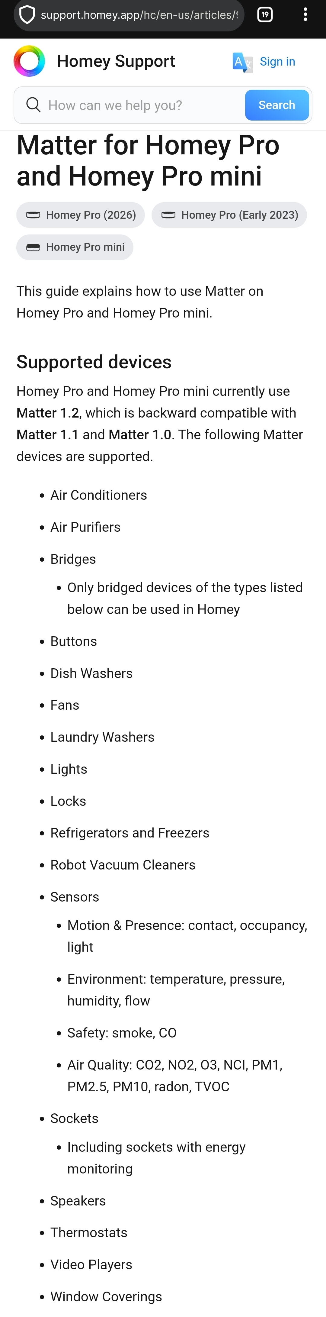

Matter is pretty limited concerning capabilities, not sure where the issue(s) occurs.
The Homey Matter overview only mentions “Fans”, not which fan-related capabilities are supported:

Matter App does not support fan devices yet, you can ask Homey to create support for fans and other devices. I have created a fork and add support for it:
Only you must install it in dev mode.
