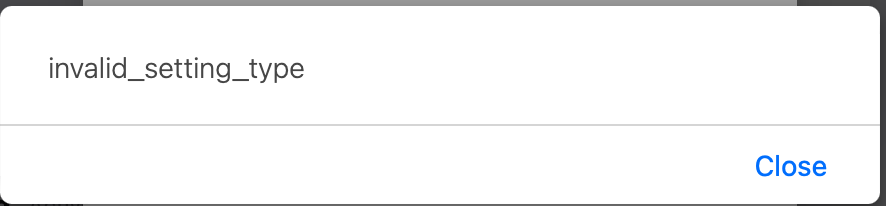

I’m getting an error when trying to add the module.
No matter what options I select, on the last step I get the error. It has worked before (on an older version of the app) But I had to remove it and add it again because of some other issues, not related to your app.

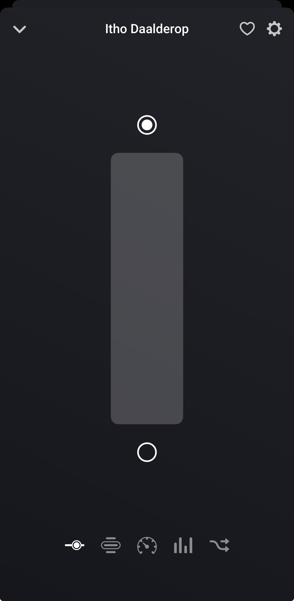

My Itho is triggered via a flow to go to 100% because of the humidity in the badroom, but the sloder in the device stays at zero.
Is there a way to fix this?

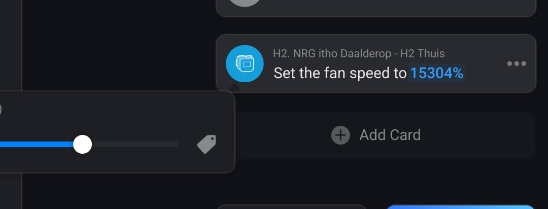

Works as expected @ Pro 2019?
@ObelixNL Stèphan, I just discovered the slider values in the Set fan speed flow card are a factor too big, in the screenshot it should be 50 - 60% ish:
(Pro 2019)
Fixed in 1.0.16
@ObelixNL
The slider also does not stay at the correct percentage.
When I lower it, it slides up again
The same applies when I do this with the virtual remote then it does not update the status of the slider
That’s correct , the slider in the NRG Watch portal is also on the same percentage.

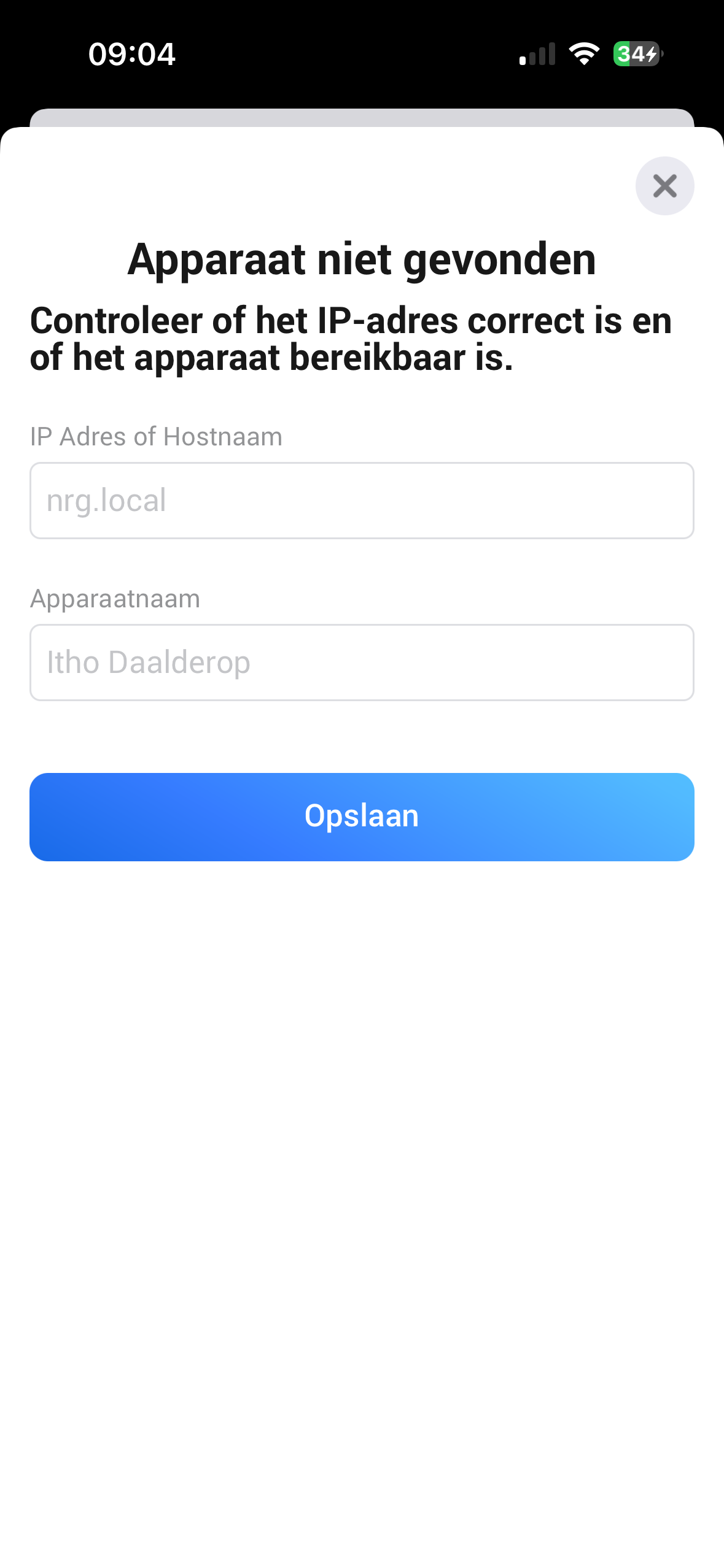

Hello, It looks like a great app. The problem I have is I can’t find my itho box.
If I enter the ip adress it can not find the box.
The webserver is available in the webbrowser.
What am I doing wrong?
Thank you.
Can you send me a DM with screenshots? also from de webbrowser

But don’t work for me the slider and with the new app I miss thismoption?
This is what I get.

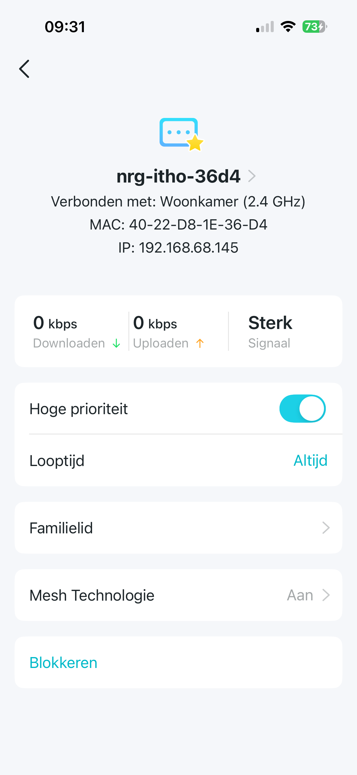

The picture of the server I Will sent to you monday. I am not at home till monday.
Thank you
Milco

Hi Milco,
●Duplicate IP addresses in use maybe?
●Is Homey’s IP address in the 192.168.68.x range?
●Do you use VLAN’s / multiple subnets?
●When you install a Net Scan app “TCP port” device, IP 192.168.68.145 + port 80, does it detect the nrg print?
If interested, a nice network check tool here.
Can you send me a DM?
Hallo, ik heb de module geïnstalleerd en de app op homey pro, als ik op een remote van de box druk dan zie ik in de app de status veranderen van bijvoorbeeld midden naar hoog, echter in de app kan ik niets aansturen, schiet elke keer weer terug, ook een flow aanmaken om naar een andere status te gaan doet ie niet, lijkt wel of de app alleen leest? wat doe ik niet goed?
alvast bedankt.
Same here :frowning:
We can speak Dutch in DM, this threat is English only sorry.
You have a CO2 sensor? Then you must configure virtual remote otherwise the sensor overwrite the settings.
no, no co2 sensor
Works the web interface and changing the mode from the web interface?
