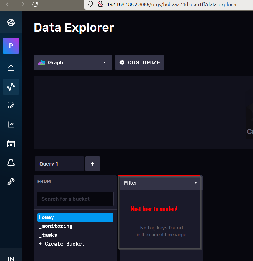

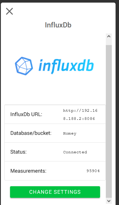

Ik heb 95904 measurements:
Maar in influxDB web zie ik onder data explorer niks.

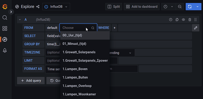

I’ve tried to install ‘data-explorer’ but it didn’t work out for me. I use Grafana interface. And there also I have to enter a query first, before I get to see any data…

The influxdb app states it’s connected. I get no data in my database and the measurements stays at 0

The app writes all measurements without any flow. Only flow you need is to set write frequency. I made the mistake of adding https:// in the url field in the app configurator.
Take a look in the configurator to see if you have any measurements and if the connection is online.
