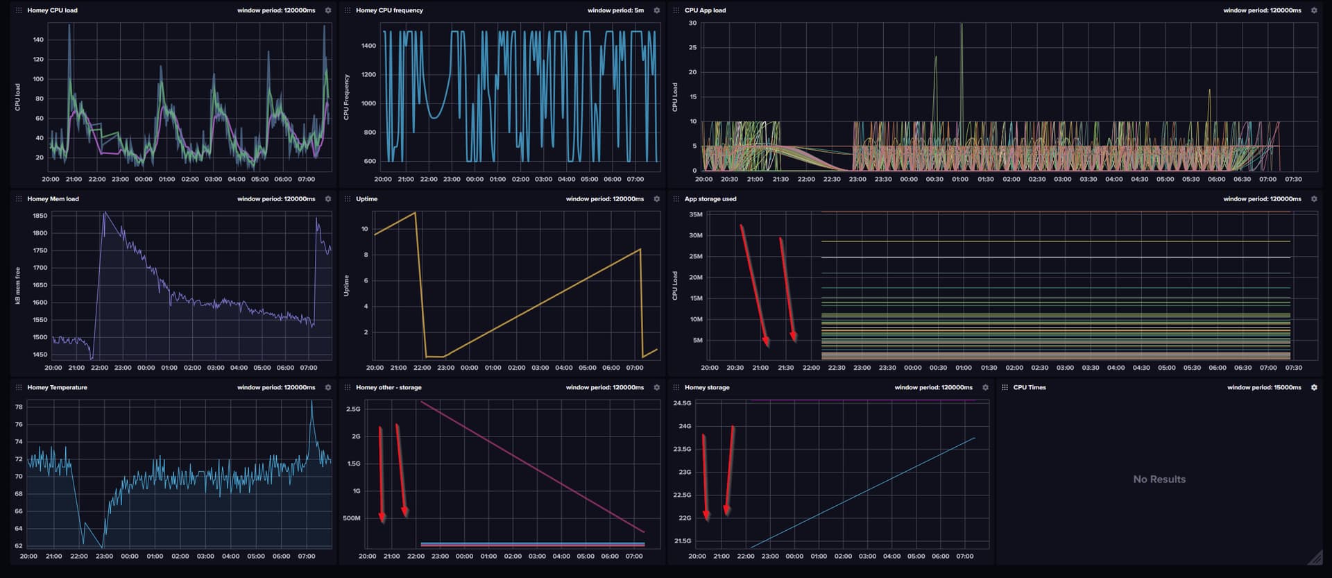

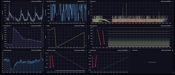

@balmli , may I ask, memory details per app are not being stored ? Seems I can find CPU per app but not memory, I’m on HP23. Thank you.
I’m using
obrazek
I see in the Influx DB only CPU :
obrazek
Just maybe update to the previous message - seems that 1 out of 7 restarts or so - I get also APP STORAGE readings, otherwise it’s empty. I always got App CPU measures but never App RAM - I’m suspicious that this inconsistency has something to do with HP23 - any experience anyone ?
