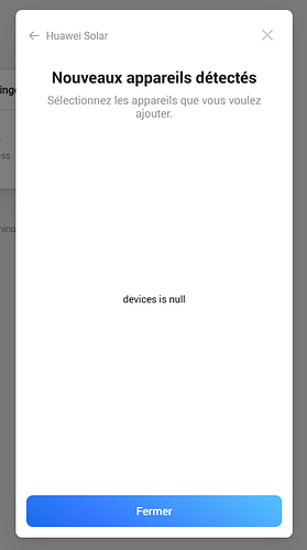

Same for me, I tried with both System after/before 2023 and Web route. But I get all the time ā€œDevices is nullā€.
My address is uni004eu5.fusionsolar.com
Any help ?
Thanks
I am having the same issues…
Huawei PV system + Huawei Battery. Can’t add them in Homey.
I’m getting: null is not an object…
Any solutions on this?!
