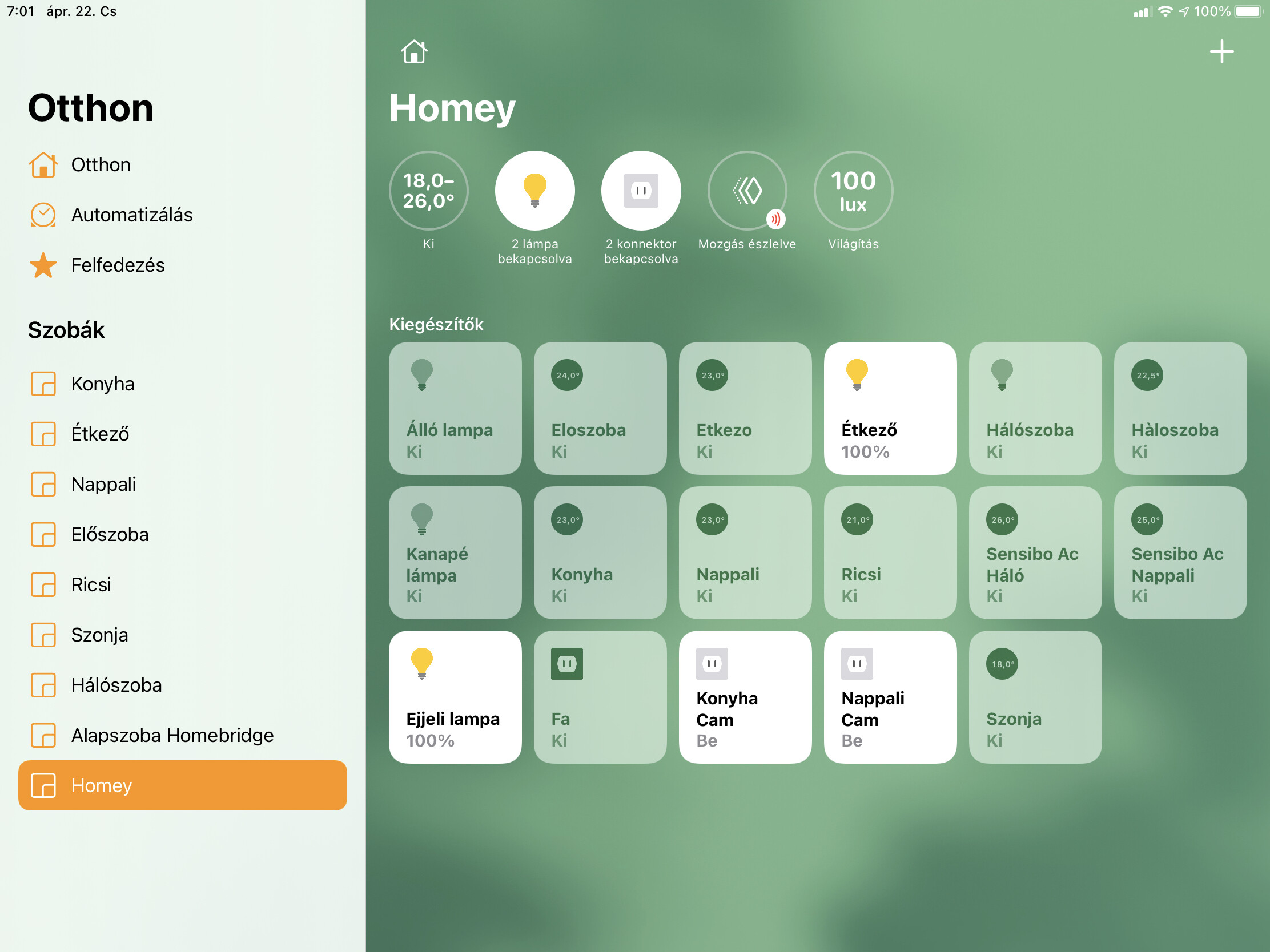

Hi I use Evohome Wifi and HR92 termostats my home, original app in my phone login total connect comfort international because i live in Hungary, alll work fine. I install this app homey and set my user name and password notification say not connected. this evohome not work this login:?Home | Total Connect Comfort International And 1 more if I use to add homeykit to add homekit all termostats look like off. but no all is work
Hi I send diagnostic file 1983436a-8821-48ca-9b56-02c3a4d4d9a6 I hope you find somthings if I add homeykit app to homekit all devices see off and I not see in developer app HR92.

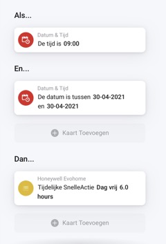

Hi someone can share 1 flow how to make for example, friday is public halliday and not normal workday, how to set a evohome change low tempriture like day off mode? thanks
The then card is made by selecting honeywell from the app section. The option to select will probably translate to “fast action”
