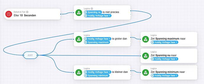

Those trigger cards are not reliable, so I now use this now:
The 10 seconds are not synchrone but that is not a problem at all.
If the “now” is not changed then nothing is happend.
Also Mini & Maxi Voltage are not often used.
The pressure on the system, I think, is less high then 4 trigger card on the same time.
