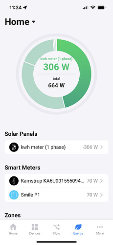

Hi Jeroen, replied on this entry, as I think it might be related: my kwh meter (1 phase) does not show the solar panel output on the outer ring, instead it add the absolute value (-306W) to the inner ring as usage.
The graph should show (as I understand it):
  • 306W on outer ring a produced by solar panels
  • total consumption: 70W + 306W=376W
If I deselect the solar panel, be selecting ground floor, the solar panel section turns purple. I assume to indicate a negative value ?
Is this a configuration thing I have missed ?
Strange it should. Did you remove/add it?

Are you sure the kWh is connected properly as well? As the Homey shows it as a Solar but still negative value.

The HomeWizard app shows de solar panel correctly (checked already).
Have not tried removing/adding.
Will add screenshot from the HW-app and try removing/adding later when back at home
Removing and re-adding solved the issue
After re-adding, the device was added under the ‘Devices’-section; after changing ‘What’s plugged in?’ to Solar Panel, all was ok
Thanks Jeroen for the quick reply !
