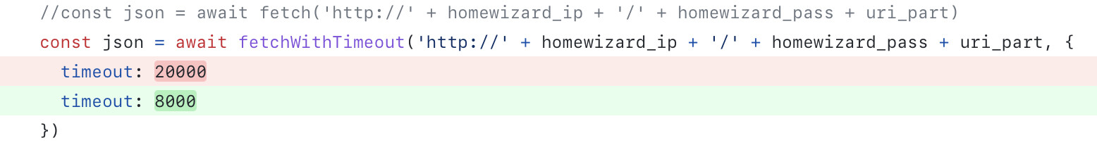

This has been adjusted to 13sec in test version 2.1.9 which is still pending approval. Polling is every 15 seconds to Homewizard and as of 7.4.0 the app log is trashed with errors so I need to do something about catching the real problems from the slow Homewizard that are unable process within a acceptable time. But if you have better suggestions?

The issue is that Homewizard (legacy) so the old unit, has a crappy wifi chip. And with the introduction of Honey firmware 7.4.0-RC22 recently I see a massive amount of crash messages. Some due to bad coding of me (sorry am just a hobbyist and not a coder) and lack nodejs knowledge or some advanced coding sometimes required to do Promise,rejects,catch etc stuff. I also see a lot of timeout and connection errors from users that clog the log inside the app. Which is related to bad wifi network of people using the old Homewizard.
I mean still even after 15seconds some users Homewizards fail to respond or finish the respons on a query poll that is needed every 15/20 seconds. Now that is my pain to manage and nobody cares even. I am keep getting complaints that it is not working and suggest to improve the connectivity of their Homewizard. Now I changed the timeout to get rid of other errors but by doing that I get unhappy users because the polling fails. That is what frustrates me the most.
I am at a point that I don’t care anymore and bump the crap back to 20 or maybe 30;seconds and poll less, but then others will complain it doesnt gather recent information (motion sensors or whatever smokedetector).

Its policy to have all same vendor stuff in one app. Inside the app are drivers per hardware. This is how I can control different support per hardware. Yet the old hardware like your Energylink is not supported by the vendor anymore but still expected to be perfect in my app?
All communication for the Energylink, Windmeter, sensors, rainmeter goes through the main unit which is the core of the problem. That device is more than 10 years old, using wifi tech of that time. Prone to wifi connection issues with newer wifi accesspoint hardware. Slow, dropping traffic etc. This app keeps growing in memory when connection issues occur and store those errors in the memory.
So hence I tried to lower the timeout and getting better memory management inside in the app as it will give different smaller errors rather than the full list of lines that fail.
But I had enough people complaining so I will drop my goal and increase timeout more and poll less, don’t really care it will be less accurate.

Test version:
2.1.10
  • Increased Homewizard Legacy polling to 20s and timetout to 18s due to slower devices that have local wifi issues with app users.

Energylink fix in 2.1.11 (test)
I have tried version 2.1.11. Watched it for 5 minutes and every 20 seconds an energy update and no red exclamation marks.
Thank you.
And did buy you a beer.
Thank you!
For me there is no exclamation mark anymore with version 2.1.11.
