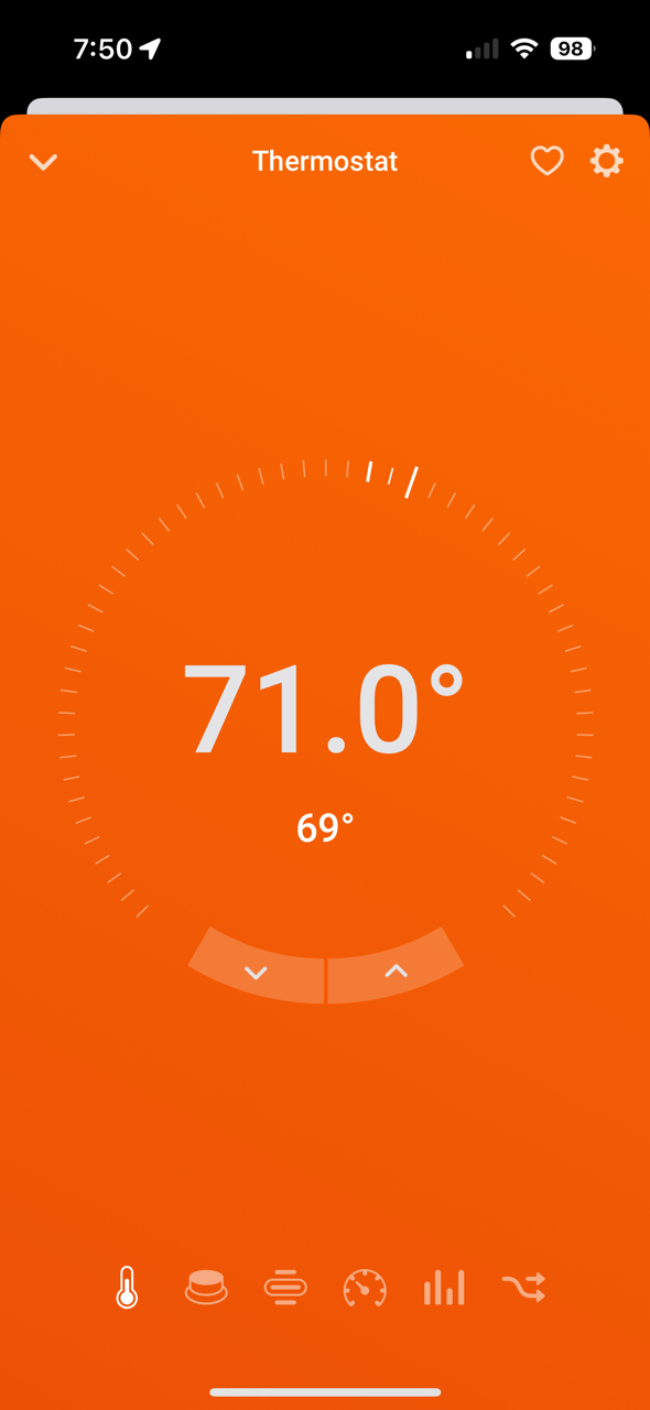

Thanks for looking into this. Here’s the update. I installed the 2.2.13 version, and didn’t see a change immediately.
  • I restarted the HomeKitty app, and went to app settings and toggled the Thermostat from devices list. Saw it disappear from Home, and toggled it back on. Same error.
  • I went to the Nest app, and did a ā€œattempt to repairā€ … no difference.
  • So I removed the device from Nest and re-added it, et voila, we have a change, but a new error. It was reading 32° C in Home, while reading 68° F in Homey (in the time I’ve been writing this, it’s gone back to 156°)
Another interesting thing is device status isn’t correct. In Homey it is on/Heat (current temp 68° / set point 71° and it’s runnng) where as in Home, it’s showing as Off, current temp 156°, humidity 0%, and set temp 50°)
Both measure_temperature and target_temperature capabilities in Homey aren’t correct, they should contain the Celsius value but they contain the Fahrenheit value. That’s an issue with the Nest app, not something HomeKitty can fix.
Also, nest_thermostat_mode is a custom capability, unique to the Nest app, and HomeKitty doesn’t support those.
I’m not sure why the humidity isn’t shown correctly, though.
Oh, no, the measure_temperature Temperaturenumber 69 and target_temperature Heat number 71 in Homey are correct and match what’s in the native app, and on the device display (all in F). It is only the Home where the problem exists.
I’m trying some different formulas, and it’s possible that the calculation is trying the (9/5) multiplication against the F temperature, and then adding 32 to the result. I believe the correct order of operations is {(°F-32)* (5/9)} to get to °C.
If I try (°F * (9/5))+32 it gets to 155 which is what’s showing up in Home.
I understand that you think they are correct, but they’re not: they should be in Celsius, because that’s what Homey uses internally. Only when temperatures are displayed (mobile app, web app) should they be converted to the local temperature scale.
This is the unit definition of measure_temperature:
  "units": {
    "en": "°C"
This is an issue with the Nest app that I cannot fix.
What’s happening is that Home also assumes that the temperatures supplied by HomeKitty are in Celcius, and subsequently converts them to your local preference.
