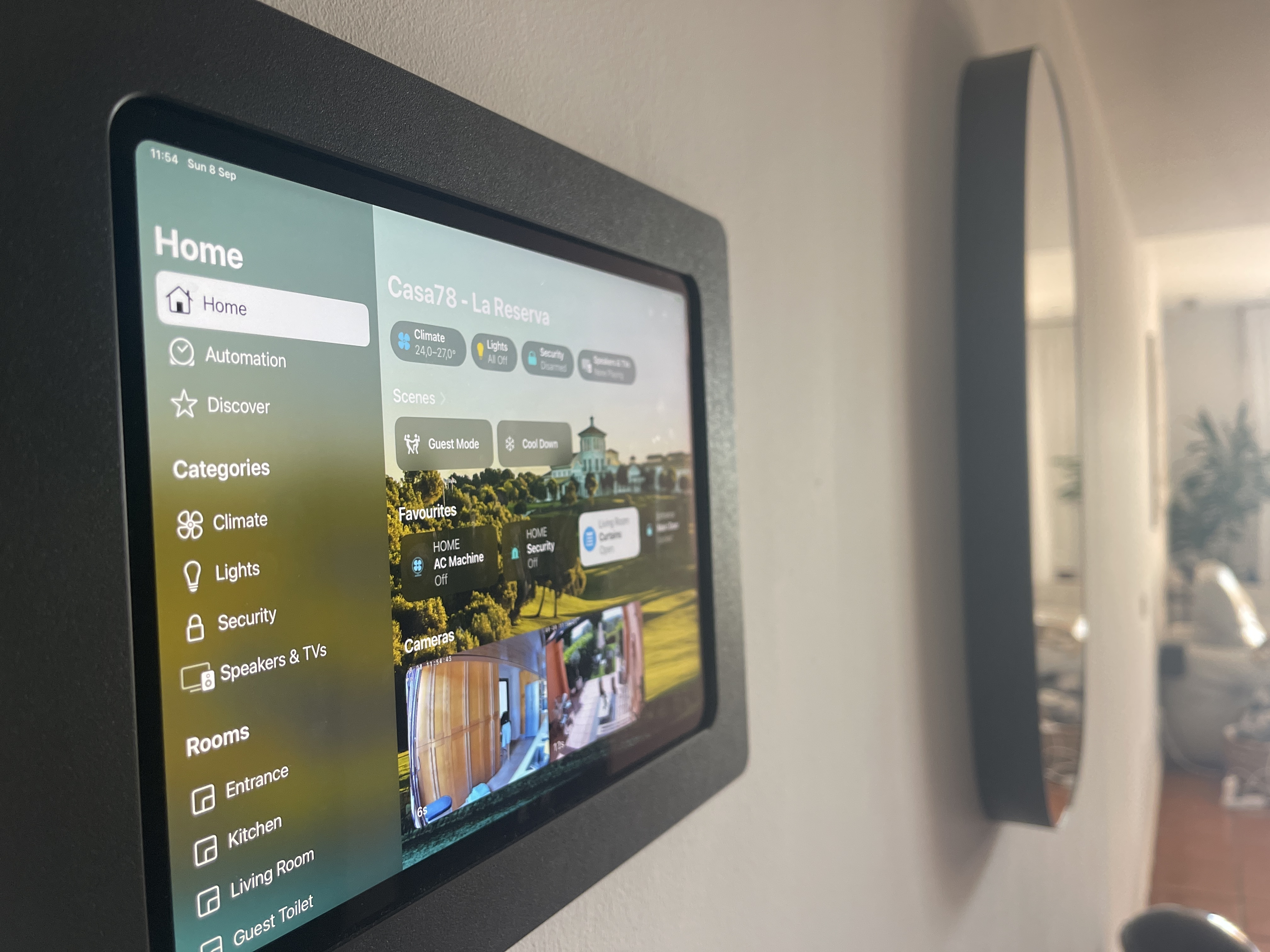

Just a message to say this app is the most useful one for me so far :clap: thank-you! My life is easy thanks to @robertklep ! :heart_eyes::raised_hands:
The app is stable and working well.
I am using the test version tho, the stable one has less features :wink:
