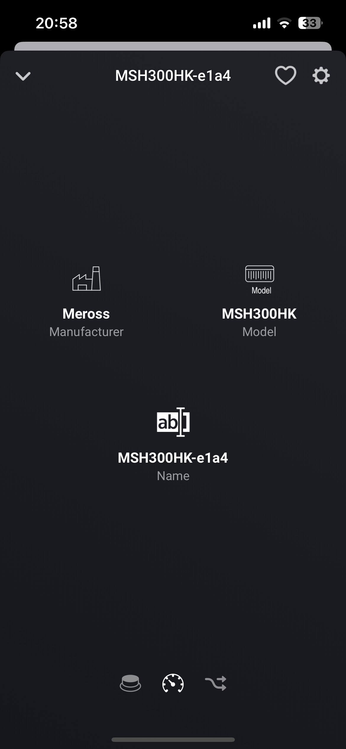

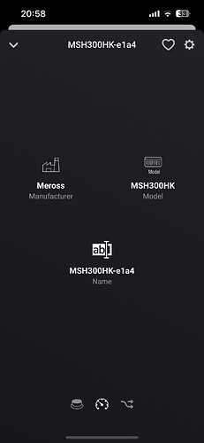

Well, I did what you said and it appeared in the Homey app but with error.
Does that mean it won’t work or I did sth wrong?

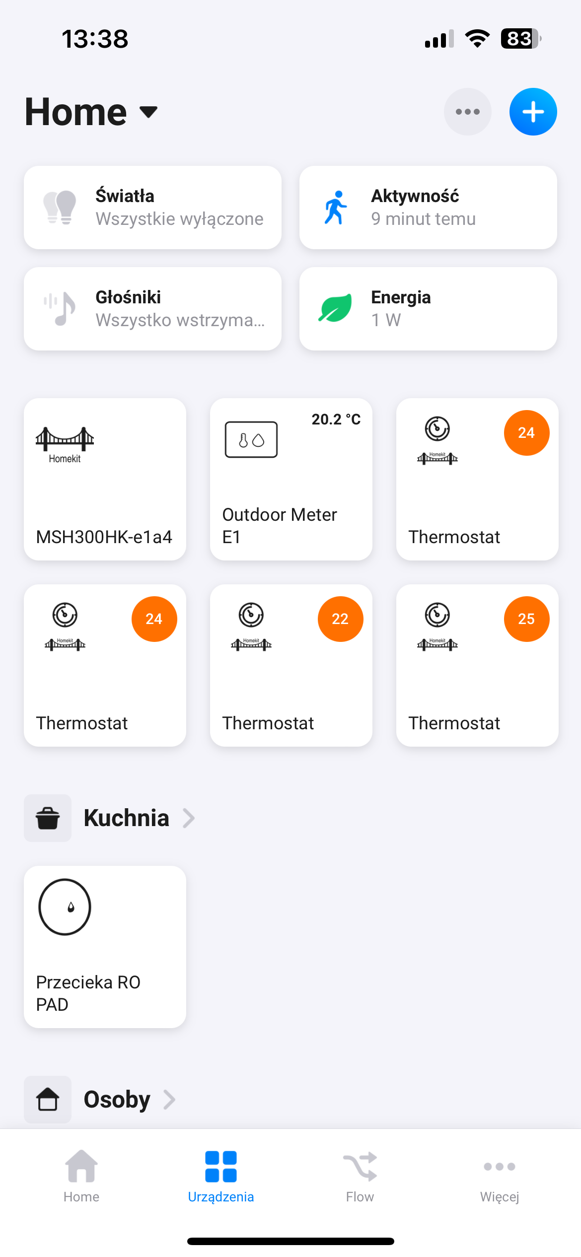

It’s working! :smiley: thank you very much @Martin_Verbeek!!
It would be nice if you could tell us how you actually made this work :grinning:
Just install Homekit controller app and add the Meross device? thats it?
What if the meross device is already in a ‘home’ (homekit)?
Just like it is said in the 1st post of this. If you added it to apple home, you have to delete it and than go to Homey app and add Meross HUB in this Homekit Controller. After adding it you than go again to add new device in controller and all devices you previously added to Meross Hub will show up. So you have to add them to Homey one by one. :slight_smile:
