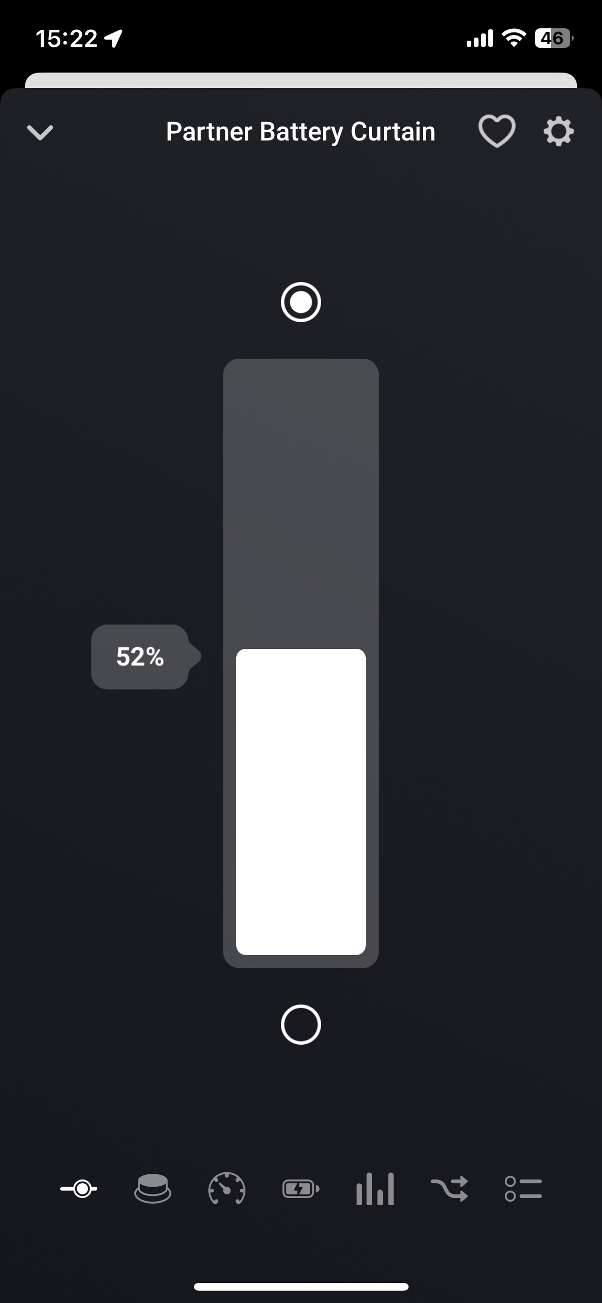

Damn that was so fast! Thanks! Battery status is fixed! Position still 0.08% instead of 8%
But the slider itself seems to be correct. Like the slider positions, when I drag to ~25% it goes to 25% but shows 0% as description and 0.25 as position status
Edit: while dragging the slider, the description is correct, but once I let go it shows 0%.

With 0.25 as status i guess you mean on the screen below?
Exactly
When using the slider, it does execute correctly on your curtains?
Yes, while dragging it shows the correct number and sets the blinds correctly but doesn’t show the correct values afterwards it’s weird

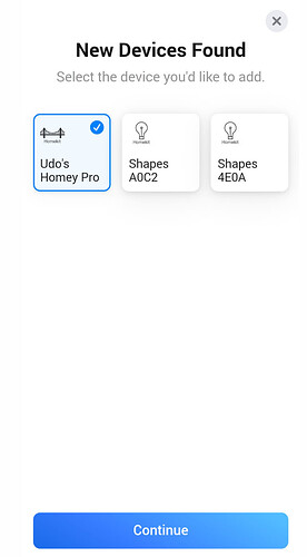

Question:
I do have 10 Nanoleaf bulbs here (LINK), they are “Homekit over Thread”.
Today I clarified with Homey that “Thread” on Homey means “Matter over Thread” - no (direct) support for my devices. However, with the “Homekit Controller” I believe I can add them, correct? Unlike “Thread over Matter” (11 digit code) my bulbs have a 8-digit code…
I hoped I just need to add the device…

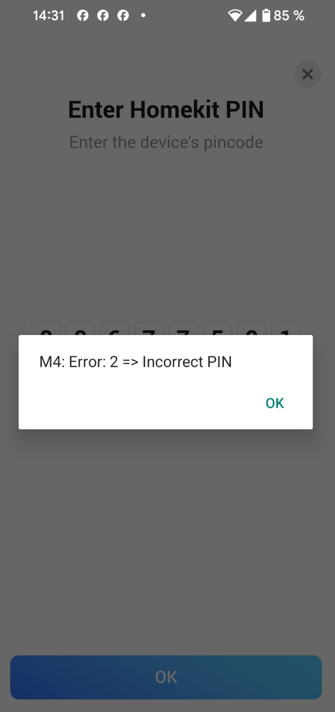

I don’t see any bulbs, when trying to add them via a Pairing code…I get “M4: Error: 2 => Incorrect PIN”…
I do not have any Apple Infrastructure. Do I miss something? Am I thinking in the wrong direction?
