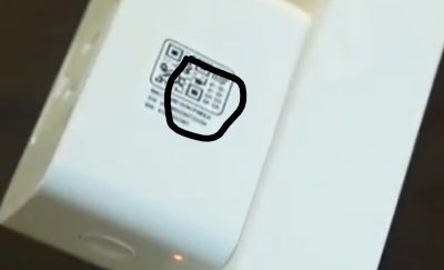

Ok, so I have been spending the last few hours slowly moving devices from HomeKit into Homey. So far, literally everyone of them has turned out to be a matter device - so it was easy. Now I have run into my first non matter device. It’s a smart plug that is Apple HomeKit enabled.
For matter devices, I simply put the device into pairing mode through HomeKit, copied the code, removed the device, then added it to Homey. But with this plug, I don’t have the option to put it into pairing mode in HomeKit. Not even sure I remember how to put this plug into pairing mode.
Now, I DO have the HomeKit QR code… can you explain to me (remember, I am not very smart) in a detailed way, how I would do this so I can remove it from HomeKit and add it to HomeKit Controller?
What is the brand , model of the plug?
It is a Meross mss110
Was looking at a youtube pairing the MSS110 to HK. Below the qr code there should be 8 digits. That’s the PIN.
Now goto post 1 and follow that.
