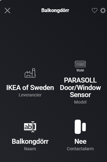

Ikea Dirigera thru HomeKit missing motion/door sensors?
Got a Homey and had an idea of using it as a cool automation umbrella over my Ikea Dirigera gateway. Started in the general forum and was asked to ask the question here…
Run v1.3.15 wish rocks! and enabled me to use the setup below:
Environment: Homey 2016 → Ikea Dirigera → Zigbee things
All Ikea Tradfri lamps + control outlets + light drivers and Sonoff humidity/temp sensors appeared and works as expected! Amazed how easy it was :smiley:
//Challenge
Missing all my Vallhorn + Tradfri motion and Parasoll door/window sensors?
Odd is that I still can see/add the “Battery” of these devices, and the tiles show the correct manufacturer, type, name…
//Question
Is there a setting I have missed that’s needed to see the full features of the missing sensors where I now only see the battery information?
