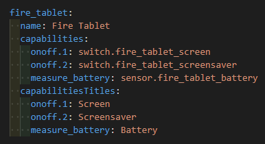

I wonder why “turned on” trigger does not work, but the “value of xxx changed” works just fine. I have 2 on/off capabilities in this compound device.
Is this issue related to the issue that @JOR1 had?

And this compound device seems ok?
It’s the same on devices with only one onoff:
Oh, compound device :sweat_smile:
May I ask why you are still using thic device if you have the possibility to build your devices in Homey with much more flexibility?
Th ecompound device was an possibility to group devices, but has huge disadvantages like restarting HA for every small change and defing things in two systems.
Since the possibility to add entities to every device on the fly I would not recommend to use compounds.
The compound device is still there for compatibility reasons. But it won’t be extended.
The possibility to add/change/remove entities is available for all others including many new features like triggers and actions.
If you are using some custom capabilities also in compound devices, you will see their assigned triggers. But not everything is implemented for compounds. It would need a duplicated logic.
So…can you switch over from compound to custom device if you want to use the new features?
Regardless of what was previously written I added the trigger to compound device.
Could you test the new test version 1.5.17?
It works fine now. :slight_smile:
