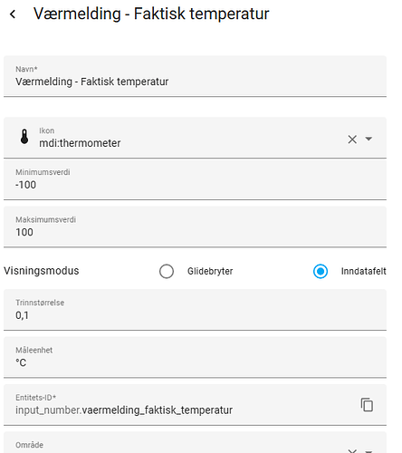

I have issues setting an input_number in HA and wonder what the correct syntax would be.
the data parameter must be a JSON based in the HA service definition like {"value": #value}. Please note the quotation marks.
But you can also add the input_number as capability to one of your devices.
I still don’t get it. I’m trying to set the value to 10.
I set the data field as follows: {“10”: 10}. Still geting Error message.
What do I use for parameter and what do I use for value?

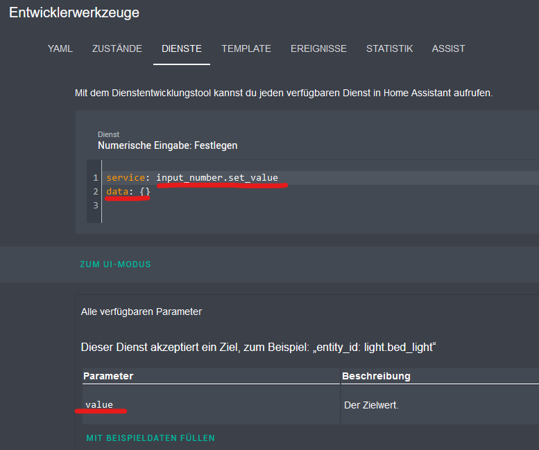

  1. Check the service syntax in HA developer tools:
  2. Use this syntax in the flow card:
    {"value": #value} where #value is your tag
It works. I didn’t think of that.
Thanks a lot. :blush:
