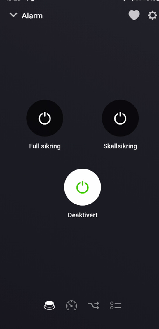

Here’s my setup:
Homey App:
Onoff buttons pointing to corresponding input_booleans in HA.
I have set up HA automation for the 3 input Booleans like this:
If one of the buttons are set to On, the automation for that button triggers. Automation will set the alarm as to Activate Away, Deactivate or Activate Home and switch the two other buttons off. This ensures only one button is turned on at the time.
This works fine without issues.

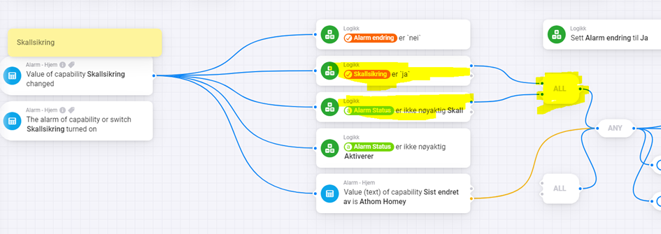

Then I add flows to Homey:
This flow with only to cards to evaluate with All card works fine.

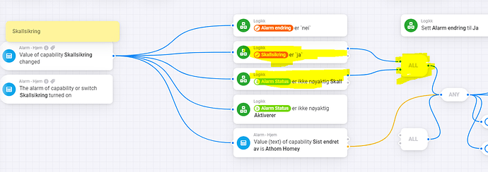

Then I add another evaluation to the All card and also setting Boolean variable:
Now I have the issue.

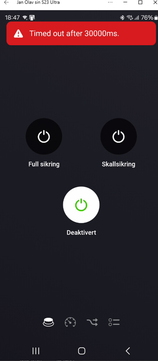

The input_booleans in HA does not change and after a while I get this error in the Homey Phone app:
Maby something takes too long to finish up at the Homey side and message to HA is never sent?
The flows always seem to trigger 2 times in a row within a second. I wonder why?
You click the button in your Homey device.
This starts sending the service call to HA.
But beforre the message is sent to HA, the app triggers the “capability changed” trigger.
And this trigger is processed synchronous (awaiting the result).
But your flow never finishes becasue the ALL condition never gets true. Perhaps that’s why the app is waiting until the timeout and the new state is not sent to HA.
I will change the trigger to be async (not waiting).
I think this will solve the timeout.

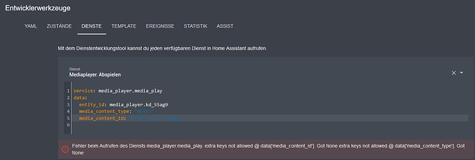

What is wrong here?
I get the same error in HA developer tools. Please check the correct syntax in HA and then use this in Homey flow card.
Aaarh I found the fault; I should call service “media_player.play_media” instead of “media_player.media_play”.
The names are too similar! :smiley:
