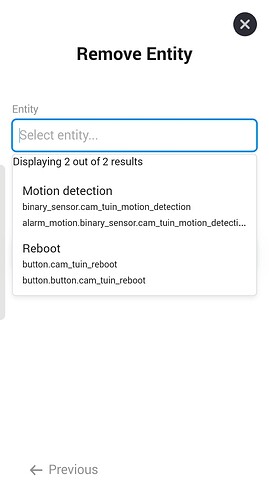

The main camera on/off button can not be removed from repair.

I could disable QuickAction for the device. This should result in a non clickable device tile. But you still can press the button inside device details.

I changed supported feature to 2, readded the camera device and changed supported features back to 3. I spent a lot of time adding all the capabilities again, but now the device is back in Homey without the camera on/off switch. Everything now works as expected.
