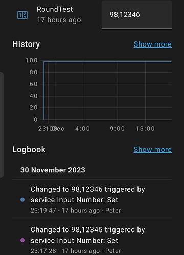

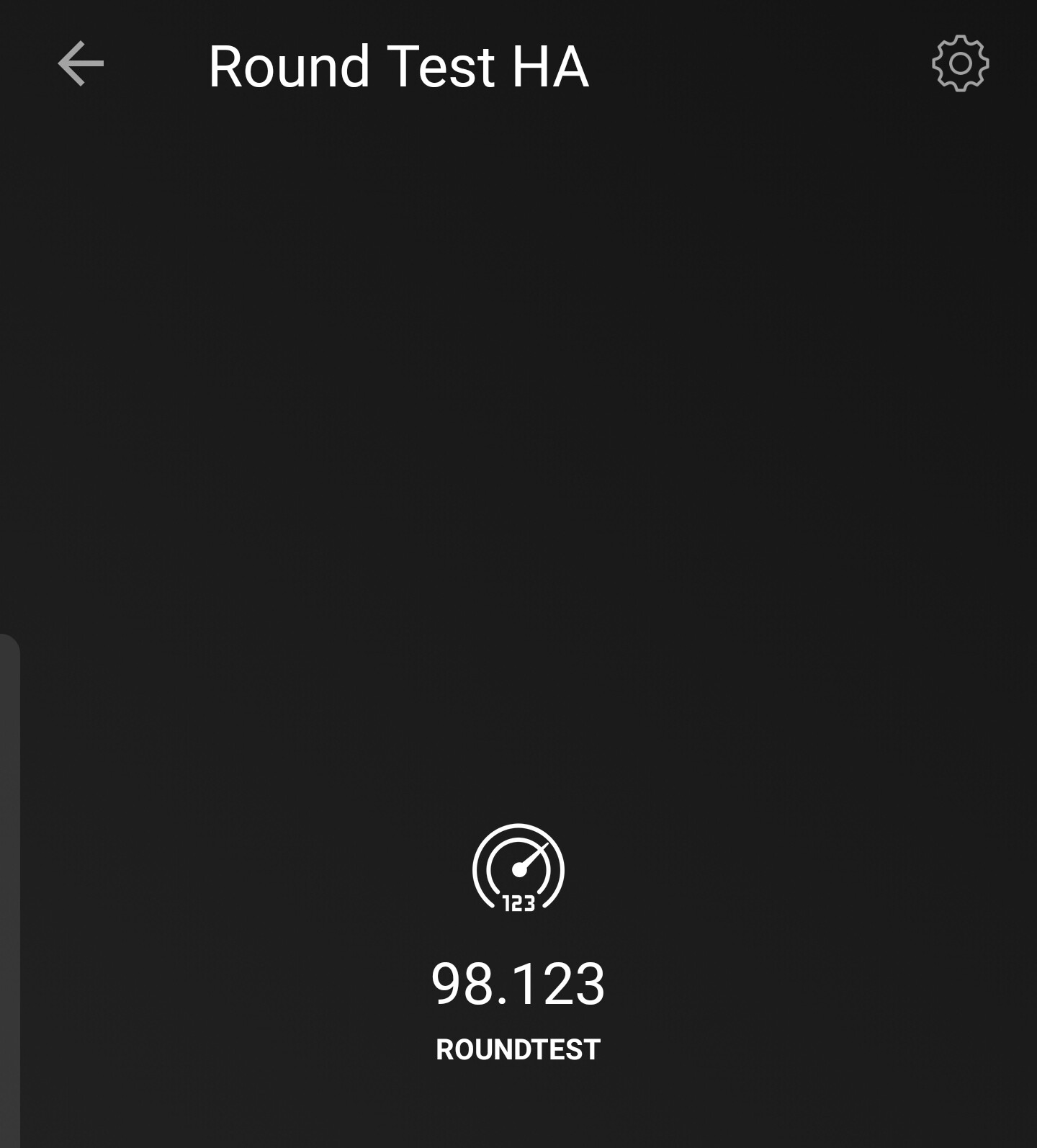

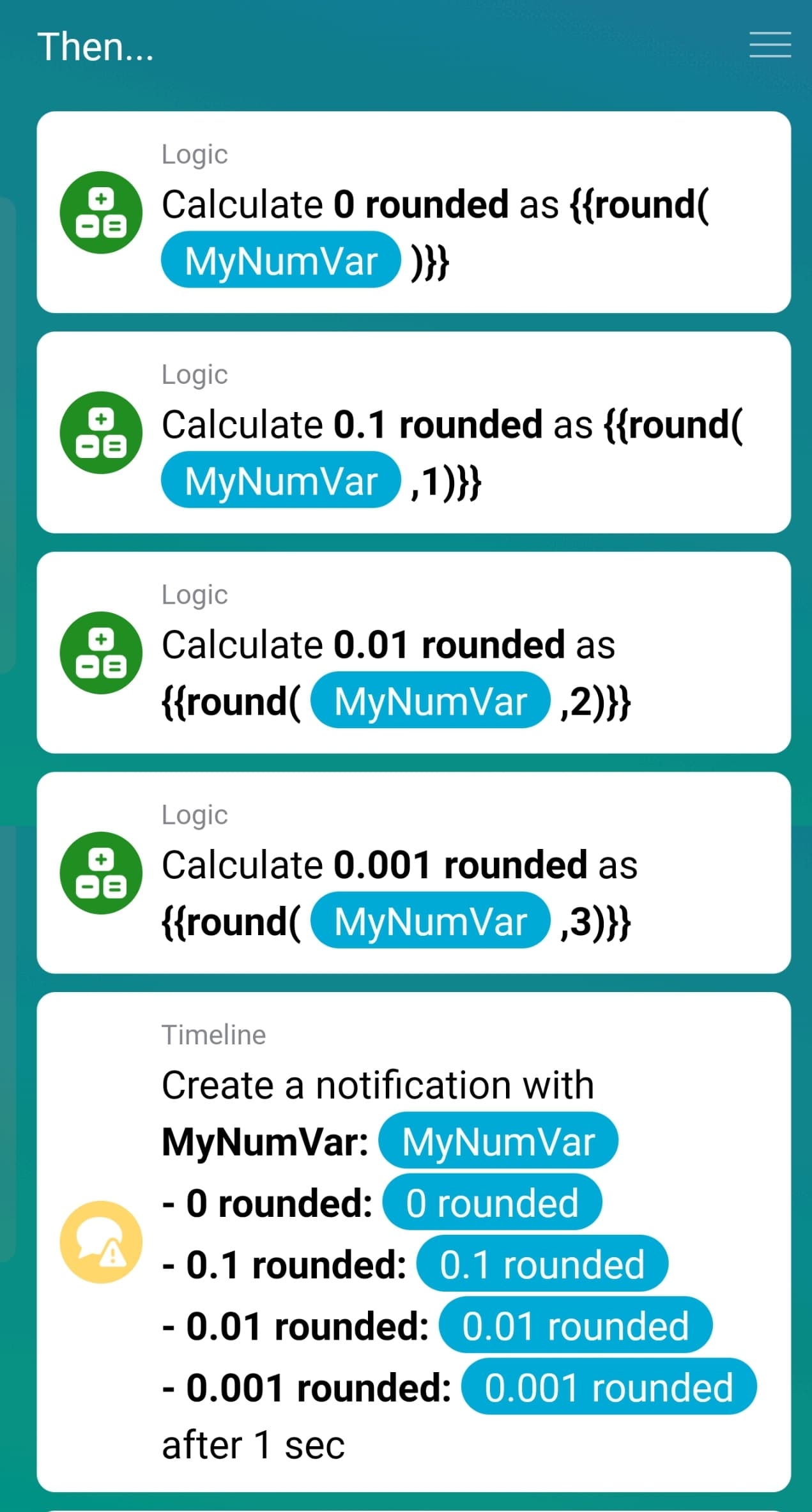

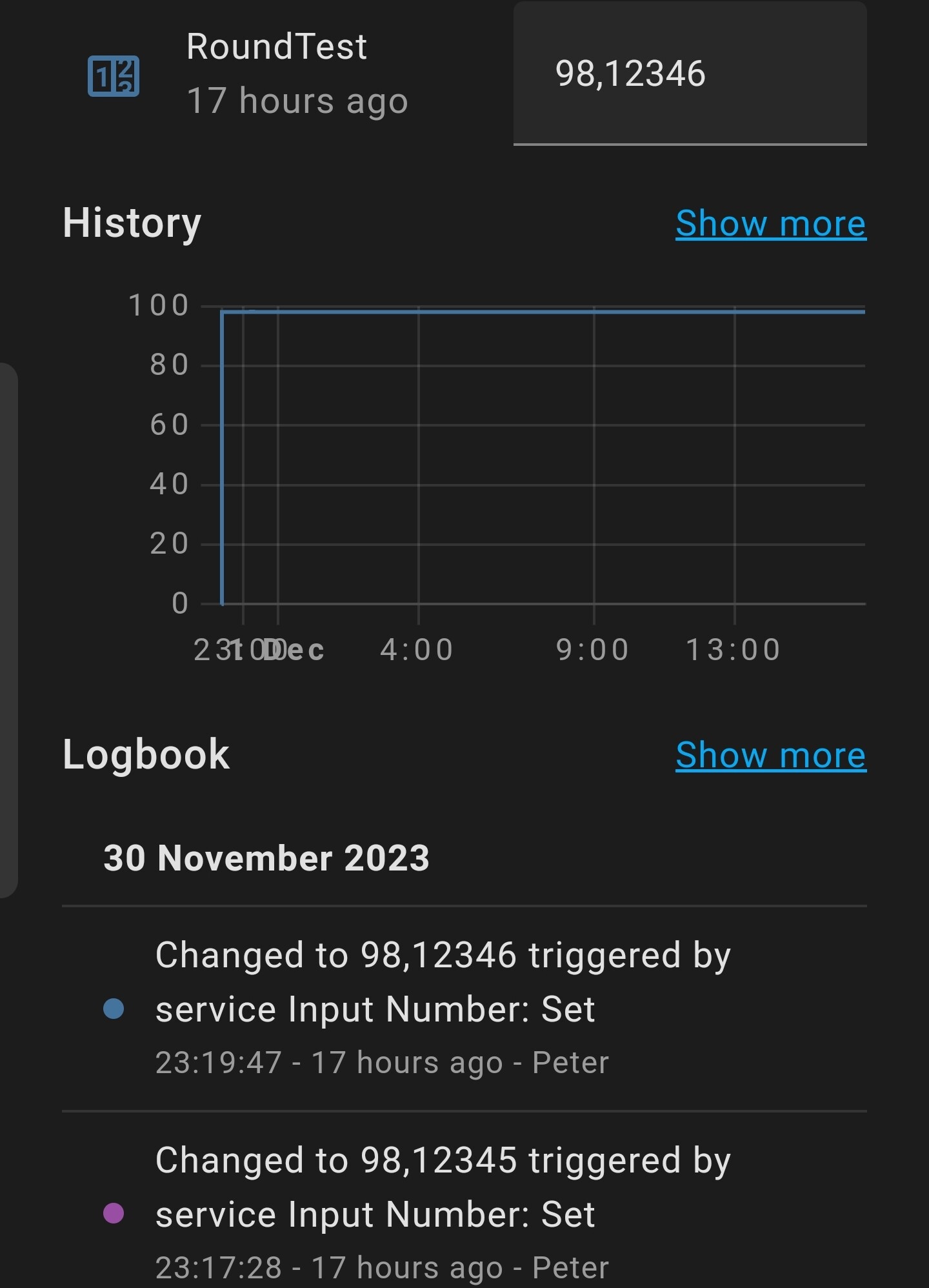

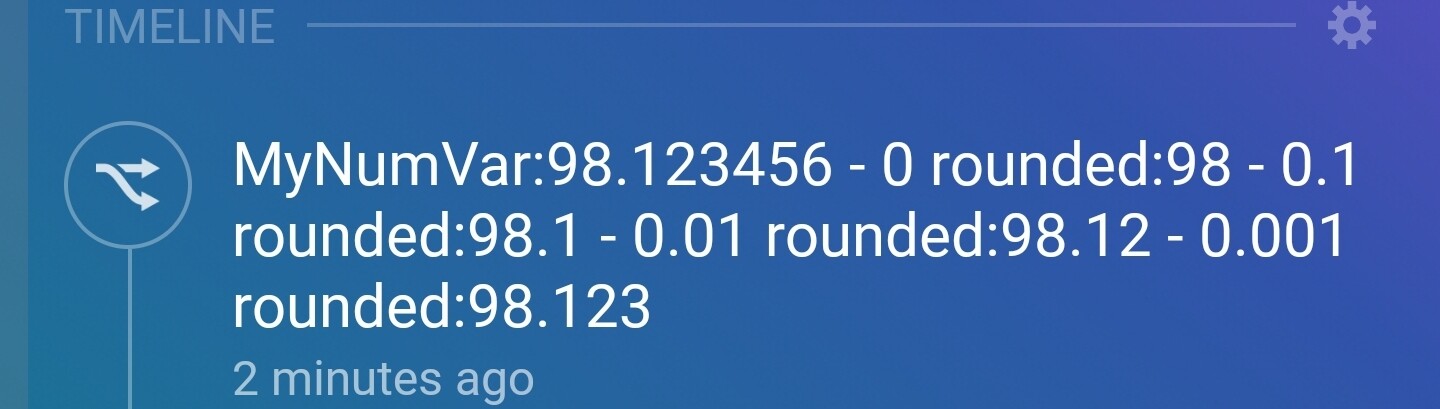

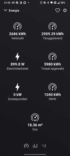

Here’s my test, maybe it helps you out:
  • The 5-digit HA entity:
  • The Homey capability with HA>Homey conversion:
  • The Homey value, rounded to 3 digits:

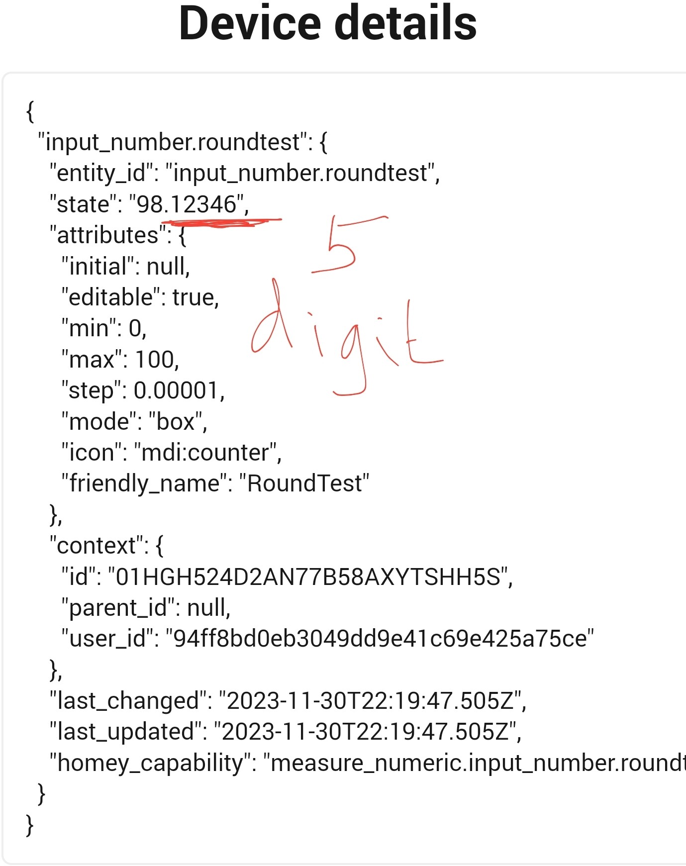

  • Detail: you can see the HA entity is a 5-digit figure:
I guess not… :-/

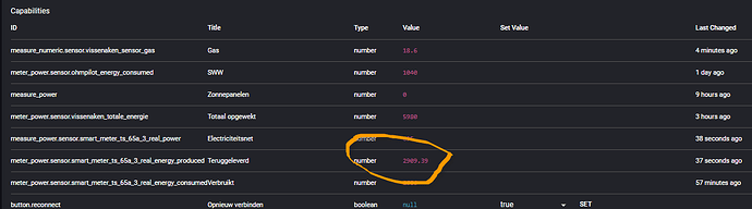

Please check the capability value at https://tools.developer.homey.app/tools/devices

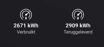

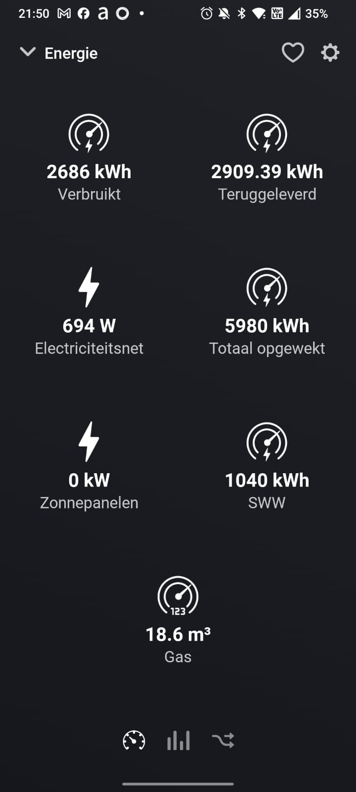

I think Homey (better: the mobile app) is cutting the decimals to fit the data into sensor tile.
An Enigma … 2digits out of 3…
I’ll live :slight_smile:
t
You are using meter_power, and that’s defined with 2 decimals.
grafik
If you use standard capabilities, they are predefined with a unit/decimals/title etc.
If you use measure_numeric as generic capability, you can use the converter to set your custom number format.
:exploding_head: :face_holding_back_tears:
measure_numeric is a custom app capability that was added to import entity values that don’t fit into standard capabilities.
But keep in mind:
If you want to use capabilities in other apps or energy dashboard, you need standard o es like measure_power.
A custom capability is not recognized in such cases.

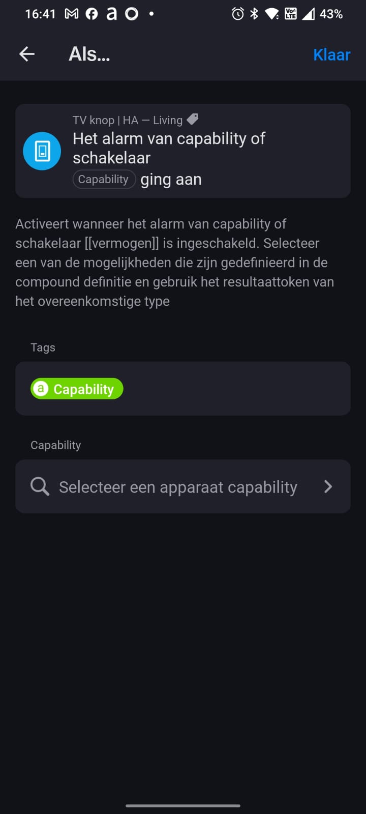

Hi, I have the above Mini Switch integrated in HA and from HA → Homey.

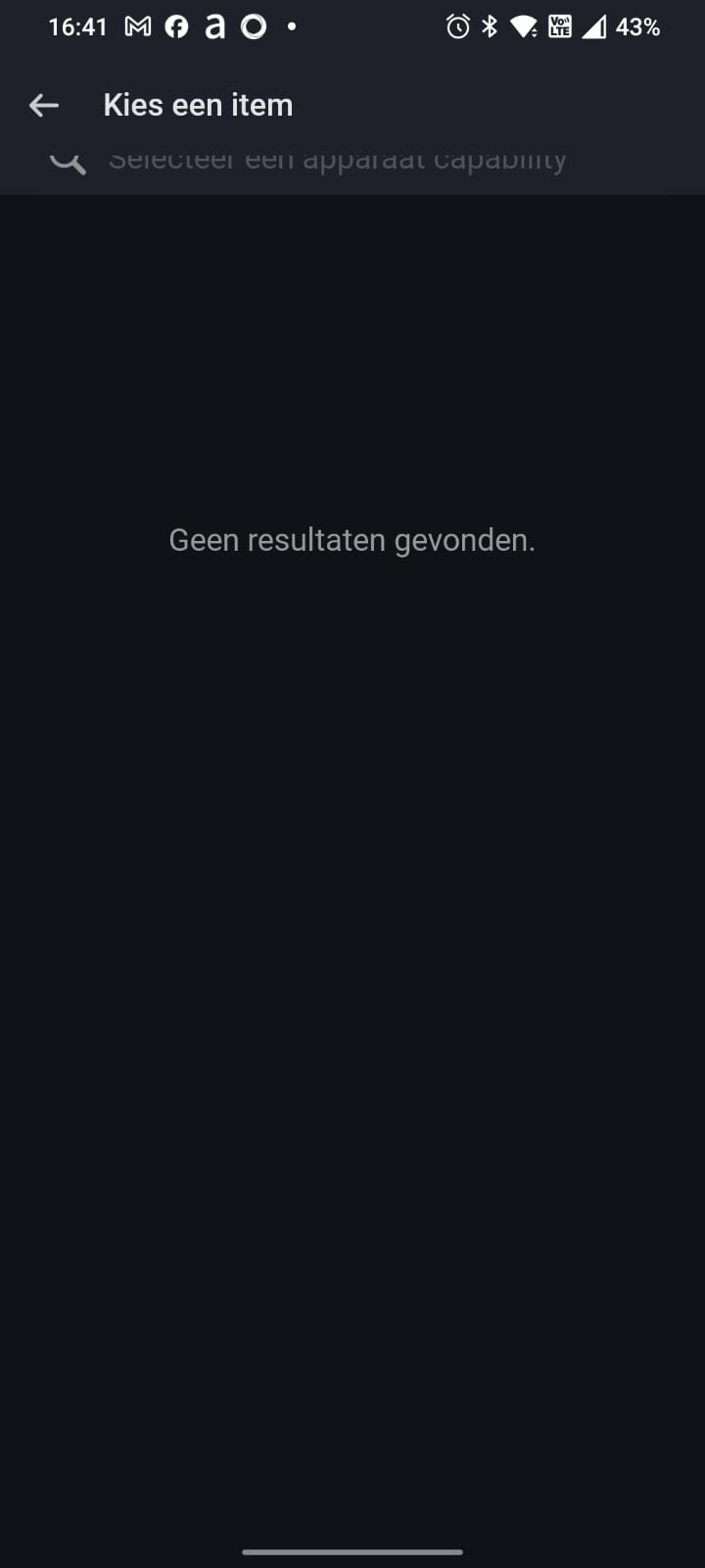

In Homey, the button state is integrated with the capability “action”. I can see the different actions I use in Homey: “single”, “double” and “long”. Now I am having a hard time to configure these different actions. It seems as if this has to be done by means of “capabilities”, but none of the above actions are available in the drop down menu. How can I add them?
remote_button_short_press:
action: {}
remote_button_double_press:
action: {}
remote_button_long_press:
action: {}
