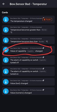

Thank’s for swift response @RonnyW, your explanation makes sense. I was trying to use that card as a trigger as, I understand, it could provide me both previous and current state but I can easily handle my flow with Presence alarm or Presence state card.
Triggers are executed after a capability change. The new value is provides as tag (for the generic trigger 3 tags where one is filled based on the type). So you can also use conditiln cards or logic cards to check the current (new) capability value.
The old value is not available in this case. But a nice idea. For the generic trigger I could perhaps add tags for the ‘old’ values, because this trigger is executed from the device and not from standard Homey code :grinning:

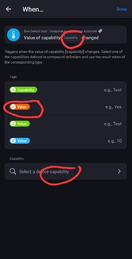

New test version 1.5.7:
  • Added old entity value tags to ‘Value of capability changed’ flow card.
As a small addition, the old capabiliy values are available now in the “capability changed” trigger card.
