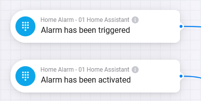

  • extended Alarm Control Panel:
    Sensors for state and alarm added. The alarm is activated at first alarm trigger and stays active until it’s deactivated using the reset button.
    Buttons to reset the alam or trigger the alarm (for test).
    Flow trigger for triggered and active alarm.
grafik
I can’t find Armed at Night (sorry, it’s in Norwegian), but there is no Armed at Night option in the flow?
