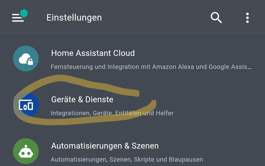

[APP][Pro] Home Assistant - Community App
There you can find details about the HA device…
If a device has several entities, they a shown the device (as icon and value). Invthis case you can click the icon, open details (gear icon) and copy the entity id.
And here you can get details about the entities.

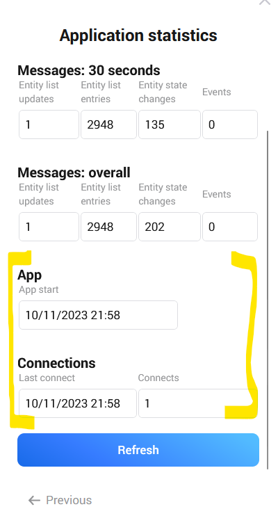

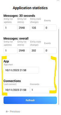

New test version 1.4.32:
