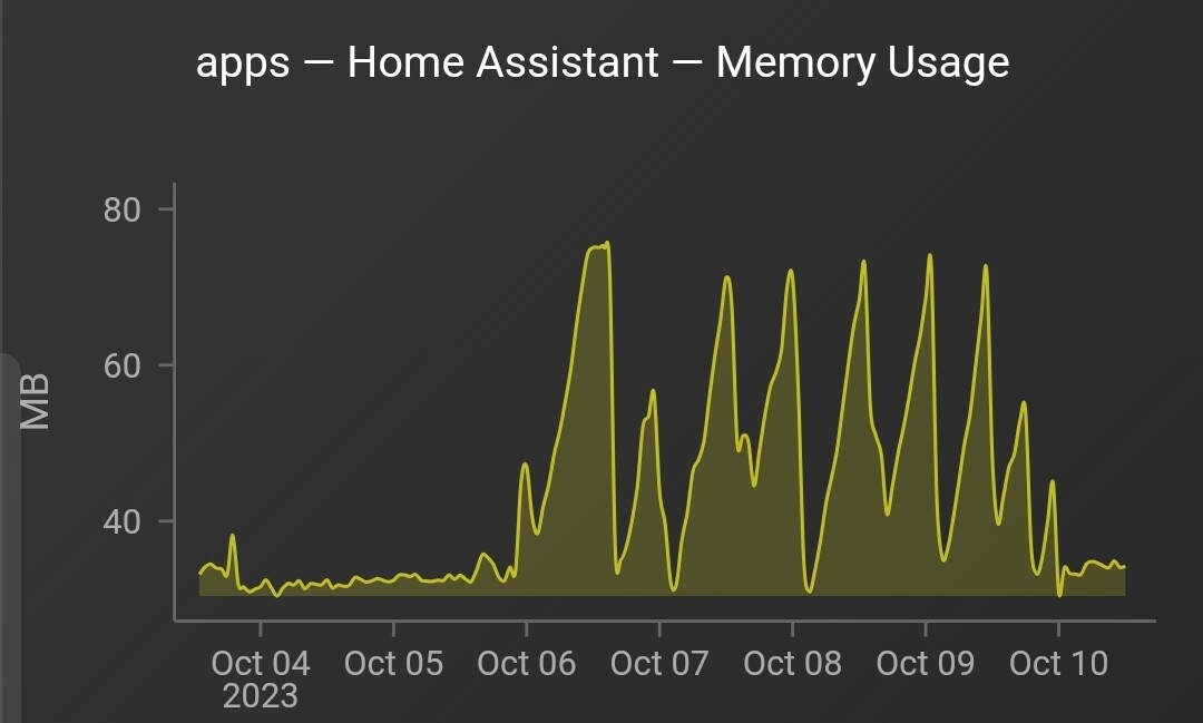

I did start the Aarlo HA integration a few minutes after 10.00. Looks like the memory usage grows a bit.
I will update app to newest version and check again.

That’s still very low and such small changes are normal.
It’s possible that HA sends the whole entity list if entities are added that can cause a little peak in memory usage.
There’s not a lot of entity updates for the cameras.
If that happens again, please check the device details if it’s a problem in HA connection. In this case there should be a message in device details. This can be fixed hopefully with the “Reconnect” button in device settings.
If the app is atopped without any information in device details, it could be a memory issue. Then you shouled see a high peak in app memory chart at thi stime (>70MB).

The changes added with 1.4.30 are removed in 1.4.31. Perhaops the HA integration triggered URL changes too often and that caused Homey to trigger the flow (including the image token and reading the snapshot. Too many images in a short time could raise memory usage.
But that’s just an assumption.

And now it’s calm and friendly again?
I think so. Let’s see during the day. I disabled the HA aarlo integration yesterday morning. There has been no new massive memory usage buildup since then. Now the newest app version is installed on Homey and HA Aarlo integration is activated. I will update you later on today. :slightly_smiling_face:
Hmmm familiar graph you show there
But it seems okay again since midnight-ish
It’s on v1.4.31 since this version was rolled out.
Yes, indeed @Peter_Kawa
I guess you restarted the Homey app at each graph top?
In my case the memory usage now seemes to have stabilized below 30MB.
Strange to see such menory usage only caused by reading of snapshot images.

All looks normal on my side now. I see the memory usage is growing, but very slowly. I’m still on about 29MB. I consider the issue fixed.
Thanks, again! :grinning:
