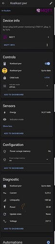

Can you show the HA device entity states?
Goto ‘Developer Tools’ and then tab ‘State’ and enter the device name to get an overview.
Looks like this
Maybe the power entity is still disabled/hidden in the device config?
Sometimes, after adding a new device, you have to enable/unhide certain (diagnostic) entities for some reason:
The main differenz between Homey and HA is:
  • Homey device includes all attributes (capabilities) in one device.
  • HA has only entities that represents a domain (like a ‘type’ of device/value). The domains defines what type is it (switch, sensor…) and defines a set of standard attributes an services. The HA device is only a group of entities.
To import a HA ‘device’ to Homey the easiest way is:
  • add the main entity as device. This depends on your HA device and what it represets). So perhaps start with the switch entity and add it as switch device.
  • Then go to device settbgs and check the entities you want to show up in your Homey device (sensors, switches, buttons).
A more complex way (but more flexible) is to add entities in repair view of a device.
You can also start with an empty ‘custom’ device in Homey and add all enties one by one.

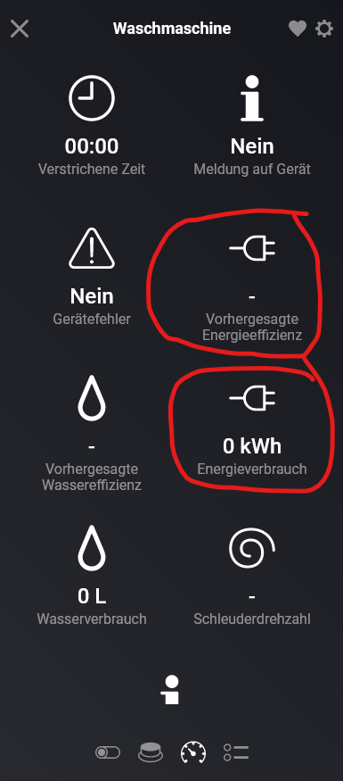

Yes, it only shows the current energy usage of the current washing program (like shown at the washing machine display). It’s a measure, no meter.
If the program ends, the energy measure is cleared.
Hmmm, that sounds very logical, Ronny, but I didn’t see this functionality before, and I would be scratching my head also about disappearing status indicators…
Mostly the tiles with power measuring just show the value 0W when no power is used :wink:
Is this HA app specific, or new Homey functionality?
Thx bro!
No, it’s Miele specific.
And yes, I made a little mistake. It’s a temporary meter value (for current program) in kWh.
Here is a screenshot from the Homey device (Homey Miele app):
There is an estimated energy usage an energy usage for current program.
So I thougt this could be also possible for other washing machines (Homey/HA). It depends on the values the device (or the API) offers.
