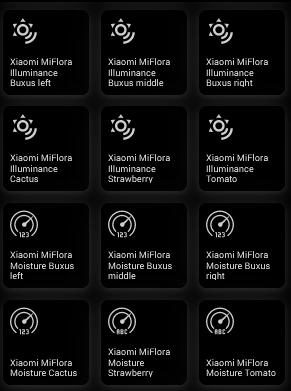

@RonnyW , not sure if someone asked already but is there some easy way to combine sensors ?
Eg. I’m trying to import from ESPHOME BLE Xiaomi Flora devices but seems it’s 6x6 entities for each sensor.
obrazek
Is there some other way, except of using CUSTOM DEVICE and search and add each and every entity separately ?
Thank you
When you add f.i. ‘moisture Buxus left’ as sensor (which will be the main capability), you can afterwards add all related device sensors (and switches/buttons), by entering the device settings, and tick 1 or 2 boxes: “Show device sensors” and optionally “Show device diagnostic sensors”
Thank you Peter, indeed I have forgotten about that option but in this case it do not work unfortunately. It’s one device with 38 entities… I see you have your Xiaomi Flora’s added into HA as well, if it’s also via ESPHOME - would you mind to share your YAML, mostly this part ? Otherwise I’m not sure why it doesn’t work for me this time.

Hi @Sharkys,
If you add all Sensors this way to HA I think you get all values as single sensor entity, but no HA device grouping these sensors.
In this case, you only can add all ‘main’ sensors as a Homey device and then add the additional sensors for every device in repair view. Or just start with ‘custom device’ and add sensors via repair view.

Ronny thank you for the details, after all suggestions, I ended up with adding it first as sensor and then repairing. It was confusing for me when the 1st added entity can’t be edited but I found the way.

Adding the entity as device (sensor), the ‘main’ entity is not changeable, because it’s the base element for this device.
Adding a custom device, you can add/remove every entity as you want.

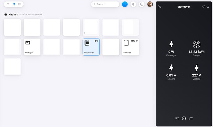

Some devices also have multiple sensors integrated. E.g. power, voltage and enery metering.
When integrated directly into Homey, these are available.
When integrated into Homey via HomeAssistant, they are no longer available.
Below an example.
Ho do I get the energy value into the Homey entity?
Do I need expert programming skills to realise this?
