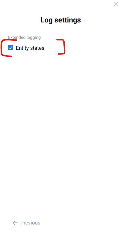

New test version 1.4.27:
  • extended logging:
Log entity state or attribute changes in app log.
Activate exended logging in repair view:
Now you can see a lot of entity/attribute changes:
Please use this feature carefully for debugging. Deactivate it if not needed.
To check the log it’s easier to copy/paste the content and use a text editor. This way you can search for entities or attributes. The log entry contains the entity state and all entity attributes. So a line can be very long.
@JOR1
I added additional entity logging. You can activate it and check the log if your garage door state changes again.

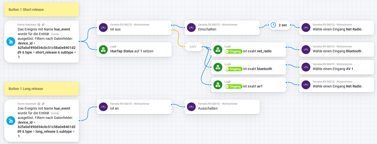

I have Philips Hue Tap 2 Dial Switch. It has 4 buttons working superb via Philips Hue HP23 app. I cannot manage to make dial/rotation wheel working. My HA is detecting wheel with no problem. How can I forward this to my HP23? Virtual device or any other way?
Hi, the Hue integration only supports events for tap dial actions.
You can take this flow as example.
Use the app flow trigger to react on HA events. There is no HA device or entity for the tap dial you could add as device.
Thanks, I will check it now.
Dial rotation can be managed by Node-red. Please check it here: Make the Philips Hue Tap dial control anything in your home, using Node-RED - Node-RED - Home Assistant Community
