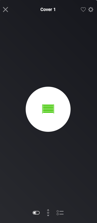

I installed new test version and readded my garage door devices to Homey.
Very nice! The Open/Close button now shows an open or closed garage door.
