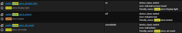

Can you check in HAs developer tools, where these modes are stored? Is it an attribute of the climate entity or a single entity independent of your climate? You can provide screenshots of your HA device showing the assigned entities and the entity details (state, attributes) from developer tools.

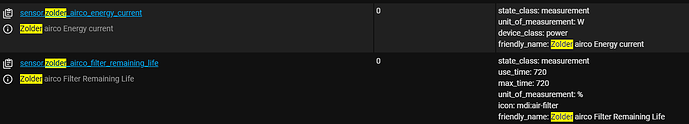

These are indeed stored as sensors. there are more sensors available to make use of. Are these the correct ones?

Switches and sensor can easily be added in device settings if they are assigned to the HA device the climate entity belongs to.
Or you add the. manually one by one in device maintenance actions / repair view.
Both ways will add switches and sensors t your device. Switches can be controlled directly in the GUI or via flow.
There is a trigger, too where you can select a sensor capability you want to react on. This card offers tags of different types you can use in the flow in logic tags.

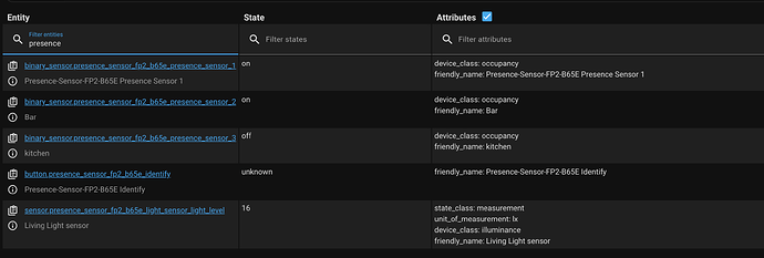

You added the binary sensor of your FP2 as sensor device, right?
And this device got the “generic alarm” capability?

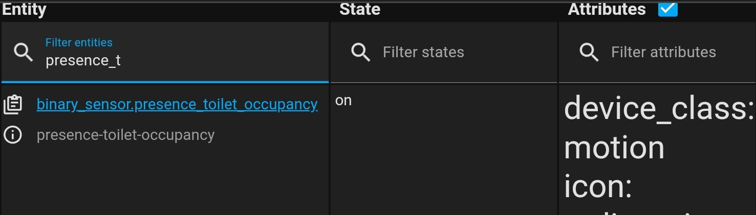

Could you please make a screenshot of the sensor attributes in HAs developer tools? I would like to know what class tjis entity uses.
And I wonder if alarm_motion could be better even if it’s presence sensor and not a real motion sensor. But in usage it’s similar. So alarm_motion could be easier to use.

yes as sensor and generic alarm indeed
Thanks, then I can map the device class “occupancy” to alarm_motion. I think that’s more intuitive.
Ah there’s the difference, my sensor has class Motion, so that explains why it was added as alarm_motion @ my Homey
