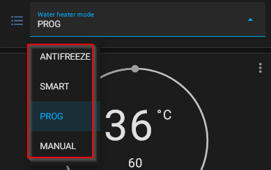

Thanks. I used FAN only as example how it can be implemented on Homey side, in HA it’s above (water heater modes - Antifreeze, Smart, Prog and Manual), which you said it’s Dynamic content and can’t be implemented. I just wasn’t sure if you understand, what I mean.

obrazek - can I do anything if the “Present modes” are not populated from HA ? In HA it’s entity called “select.water_heater_mode”
Yeah, that’s a good example of a bad implementation :grin:
The select entity is a standalone helper entity. The heater has surely added his own automation to listen on changes (like you would do in Homeynwith virtual devices and flows).
It’s not part of the heater itself.
A workaround would be to use the generic app flow actions to call a HA service. With the entity ID and a service name for select domains it should be possible to change the preset mode via flows.

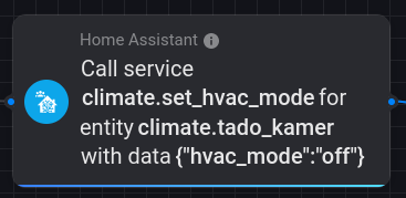

I was testing a bit, and had similar error msgs. You were so close though :wink:
This is my test device, a thermostat.
I tried the data part of the flow card with {"hvac_modes":"off"} but it results in those errors ‘extra keys not allowed @ …’
Screenshot from 2023-04-23 21-43-27
What was the issue in my case:
To check things, I made an automation action card for climate.set_hvac_mode and viewed the YAML afterwards:
Yup, hvac_mode is written without the trailing ‘s’ :face_with_spiral_eyes:
I’d love to hear if it works for you with {"option":"MANUAL"}

Sorry for late answer. Peters answer should be the solution.
options = list of possible options.
option or state (depents whether it’s the entities state or an attribute) = selected option.
Like in linked service description for the select entity.
But @Sharkys, you inserted the entity (select.water_heater_mode) and the data (should be “option”), but your service is wrong. It must be the service from the “select” domain “select.select_option” (see screenshot).
@RonnyW thanks for pointing me to the “service”, now I actually understand what “service” in HA is :wink:
@Peter_Kawa , “s” ! like in your case but for option :laughing: (and yes, the HA automation while checking created YAML helps!) :
