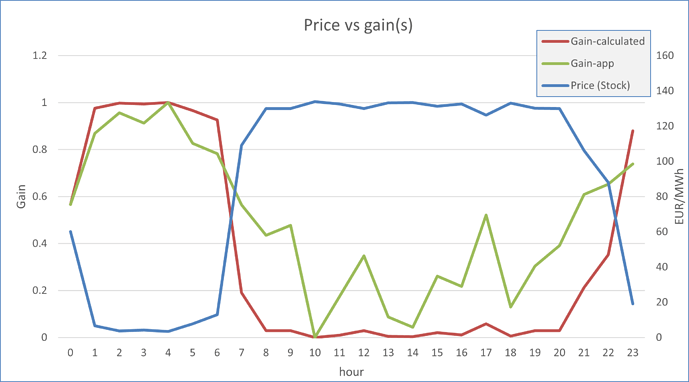

I looked at the price ratio / gain values from the app, from the last 24h (02.11.2021), for EE area, and I am still not too confident of what does the ‘price ratio’ mean, or how it is calculated. So, I took the stock prices, and computed by hand, assumably with linear scale, from 0…1, as described earlier, and then I also took the values from app for the same period and put them to the same graph. The outcome is below (blue: price, red: calculated gain, green: gain from app). PS the 00-01 hour value from the app was missing, so I used the calculated value. I noticed, that the max and min values match for 0 and 1 notations, but all the others are different. Also, it would be great to get some comments of why the price ratio value could fluctuate quite much, while during daytime the stock-price was rather unchanged?
(I used such formula for calculation: Gain = (Pmax-P)/(Pmax-Pmin), where Pmax and Pmin are max and min values of that 24h period, and the P is the current Price value). Of course, it could be totally incorrect, so please comment…
Hi
The price ratio is evenly distributed along the hours of the day. So it is not the price difference normalized between 0…1 like you have calculated, but it is the days prices sorted based on the price and given running number based on the index like so:
  1. sorted prices
  2. calculated price ratio as 1 - index / 23, rounded to 6 digits
If the price ratio is calculated your way, there might come a following situation in the intended usecase:
01.00 hour price is 0,01€/kWh and all other hours are 0,5€/kWh. The price ratio is used to control thermostat with calculation ThermostatSetValue=16+(26-16)*(1-PriceRatio). Then the thermostat set value is 26degrees at 01.00 hour and 16 degrees in all other hours. This will end up in cold house. Or this could be also other way around and you end up heating the house 23h of the day. If the price ratio would be evenly distributed over the days hours, the heating would commence with lower setting with other hours.
Hope this clears the idea of the price ratio.
Oh, understood, I think. The ratio shows then the price’s position/ranking on the asending/descending list of the 24h prices. E.q. if some price is on the top third (lowest), then gain = 1-2/23 = 0.913043 (and indexing is from 0…23). So the ratio values are fixed figures and do not depend on the actual price.
So, in this particular case of 02.11 prices, then the system would change the target temperature quite much, even when the price could be only a fraction lower from the other high prices before and after (e.g. at 09:00 and 17:00 on the graph)?
