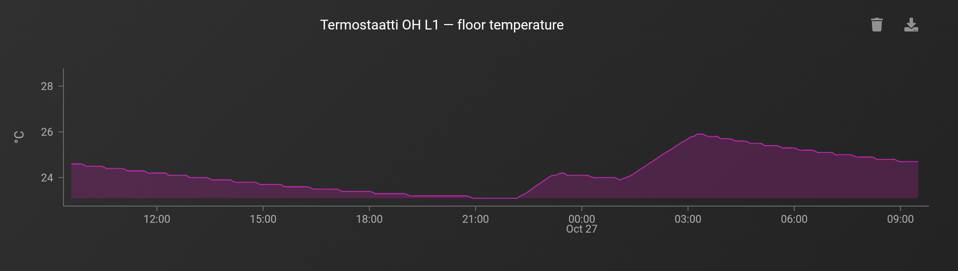

I have calculated sort of “gain” variable for the thermostat control with the use of nordpool app (could be made with this heating controller app also). The variable is calculated so that the variable value is 1, when the price is at the lowest of the day and 0 when the price is highest of the day and everything between. I have made this calculation with about 26 different flows and variables.
I use this gain variable to scale the thermostat target temperature. For example I vary my livingroom floor temperature between 16-26 degrees. The actual thermostat target value is then calculated by 16+(26-16)*Gain=Target value. This way the heating is automatically done during the low price time and this gain value can be used in different thermostats.

Hi @balmli
I have the app test version 1.5.9. Price area Finland and currency EUR. I have been following the price ratio and it seems to work as it should. Some difference between the value that I have calculated with flow but that’s bound to happen.
I also tested the High price 6 hours of the day (flow 1) trigger and other one with utility price change trigger and 6h high price condition (flow 2). I also made the same trigger with the CLI installed nordpool app (flow 3).
These trigger doesn’t work or I don’t know how to use them. I have checked that all of the flows trigger every hour, but first flow trigger stays true all the time, the second one stays false all the time and the third one with nordpool app works as it should. Can you make out of this why it doesn’t work? Have I understood something wrong how to use the triggers and conditions?
I tested also the low triggers and they don’t work either.
