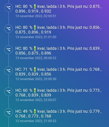

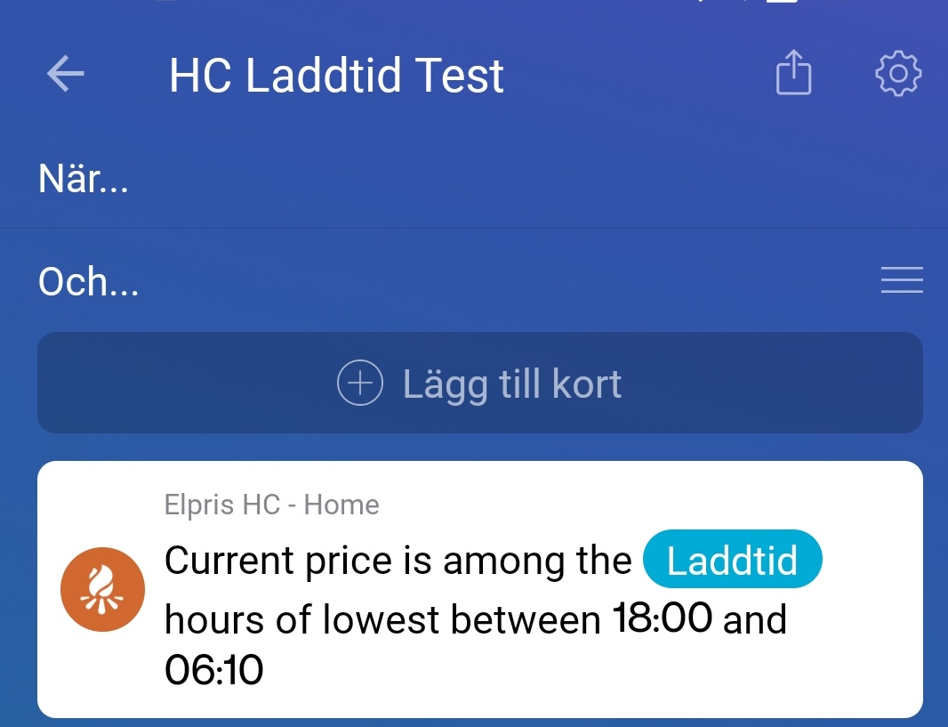

With this flow it doesn’t work over the 00.00 clock. Is there any workaround for that?
First it trigger 3 times before 12 and then 3 times after 12… The variable laddtime is set to 3.
