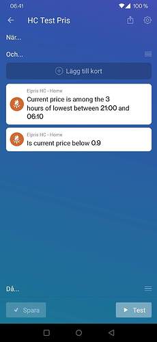

The cheapest hour during the night wont work.
During the day it is no problem…
Maybe a bug?
What price area and what day did you test this ?
Got a issue with my flow not always running 3 times between a time period… Sometimes it does 2 sometime it does 4… Mostly it’s right with 3 but not always… Is the issue it’s cause the time period is over 00:00? And how can this be adjusted/fixed?
Use the Heating controller - price changed trigger
It does…
Any clue on how to fix the count of hours when it’s over midnight?
