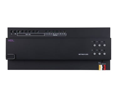

Hi
I change out my dimmer to new one MDT06015.533.
It is possible to add to app? I cant find it in search. Thank you
Hi @Stian_Royland,
I can’t find the unit in the Device list here: hdl-smartbus-homey/defDeviceType.xlsx at master · alydersen/hdl-smartbus-homey · GitHub. I’m thinking that it is because the list is a bit old, but we need the ID of the unit to recognise it.
Could you reach out to ELDI to check with them if they have a new such list of IDs? Adding it is easy after that.

Hi Stian,
New test released to HDL SmartBus App for Homey | Homey which should recognise your dimmers. Let us know how it turns out, and thanks for the updated file!
Andreas
Works fine. Thank you

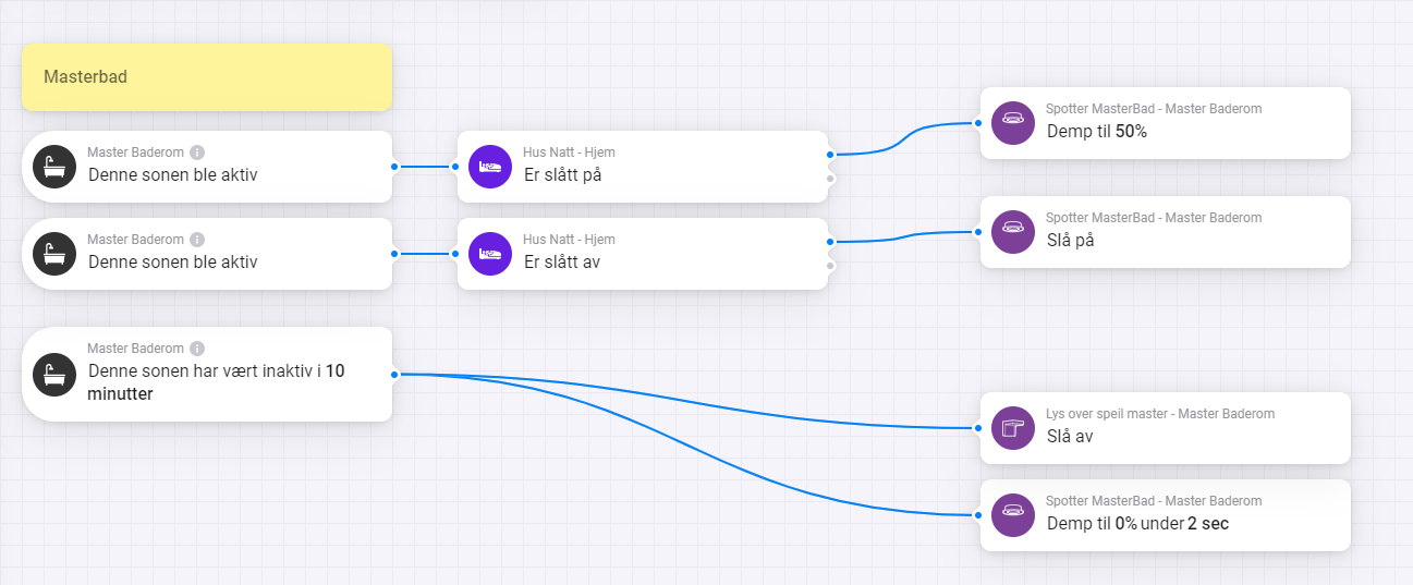

Running the Homey Pro 2019:
Anyone experiencing the same as shown on attached picture. Turning light on from motion is very often slow, and sometimes instant.
When it is slow I have however experienced that Homey do recognize the motion (from HDL), but for some reason the light is not turned on in the first phase, then turned off, and after 9-11 seconds the light actually turn on in the room. So it seems to get an off command first by some reason. Very strange.
The pictures is for Spotter Masterbad (controlled through HDLbus pro) and Taklampe Master Soverom (also controlled through HDL plugin) and is a screenshot from Homey and the actual device the flow is controlling.
Se allso my flow that controls it .
I do not think it is the flows themselves, since I experience this in my whole house, but I have considered trying with a very simple flow to just make sure. But before I rebuild the flows I wanted to check if other experience the same
Dear Homey HDL community,
No responces

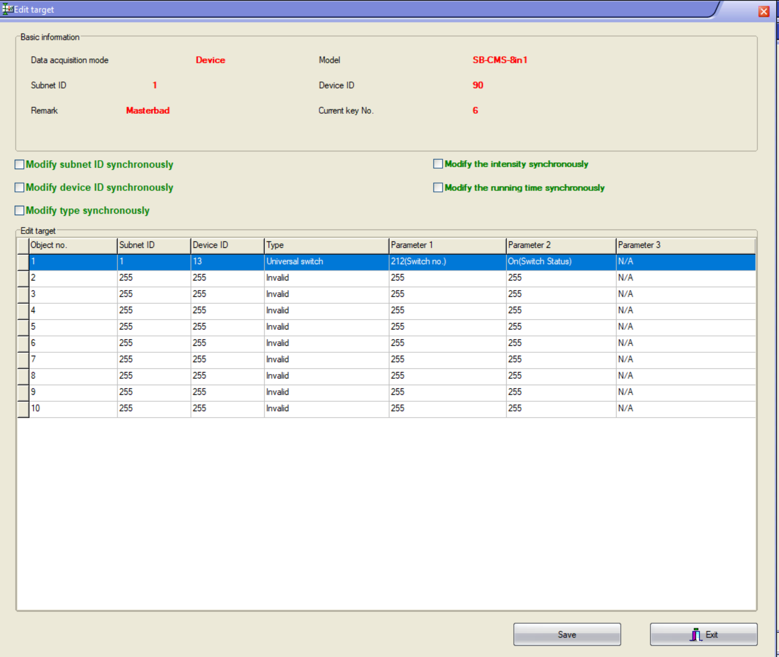

If none of you experience my issue, and do not see any challenges with my Homey programming, I guess the fault must be in the way my motion sensors are set up in HDL bus programming tool.
Can anyone please confirm my setup in HDL is correct ? This is really making me crazy
Movement:
No Movement:
