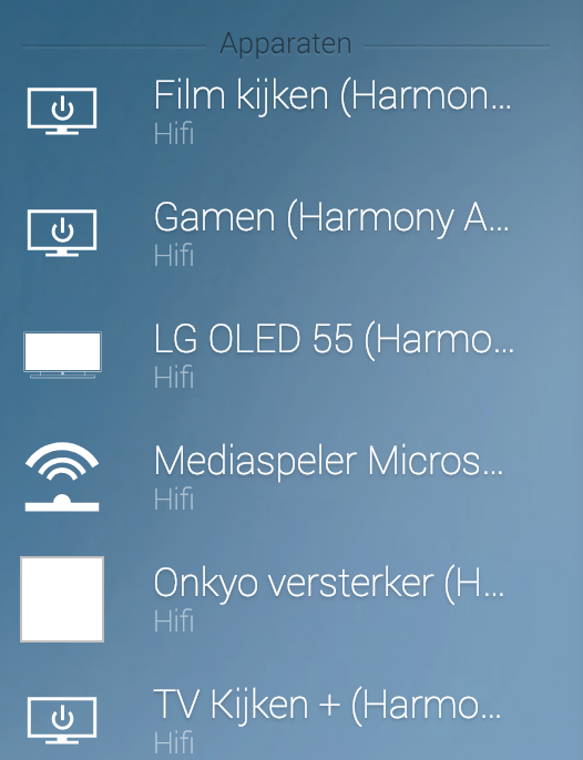

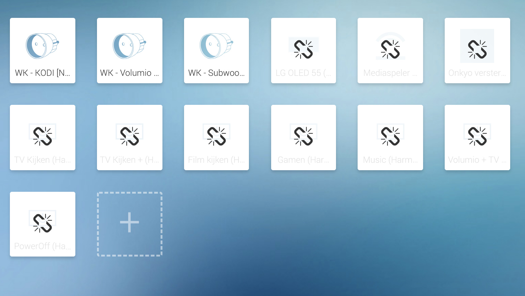

I restarted the App.
This is the devices page:
40
After the screenshot, this happened:
53
And within a second or 5 everything is active again.
This is available in the flow editor:
So. missing a couple of devices!
I added both the HUB and the DEVICES. Should I only add devices?
@Eternity are you on firmware 1.5.x? If so can you open up app.json and remove this line (its there 3x): “deprecated”: true,
and after that CLI install again.
Yes, still on fw 1.5.3
