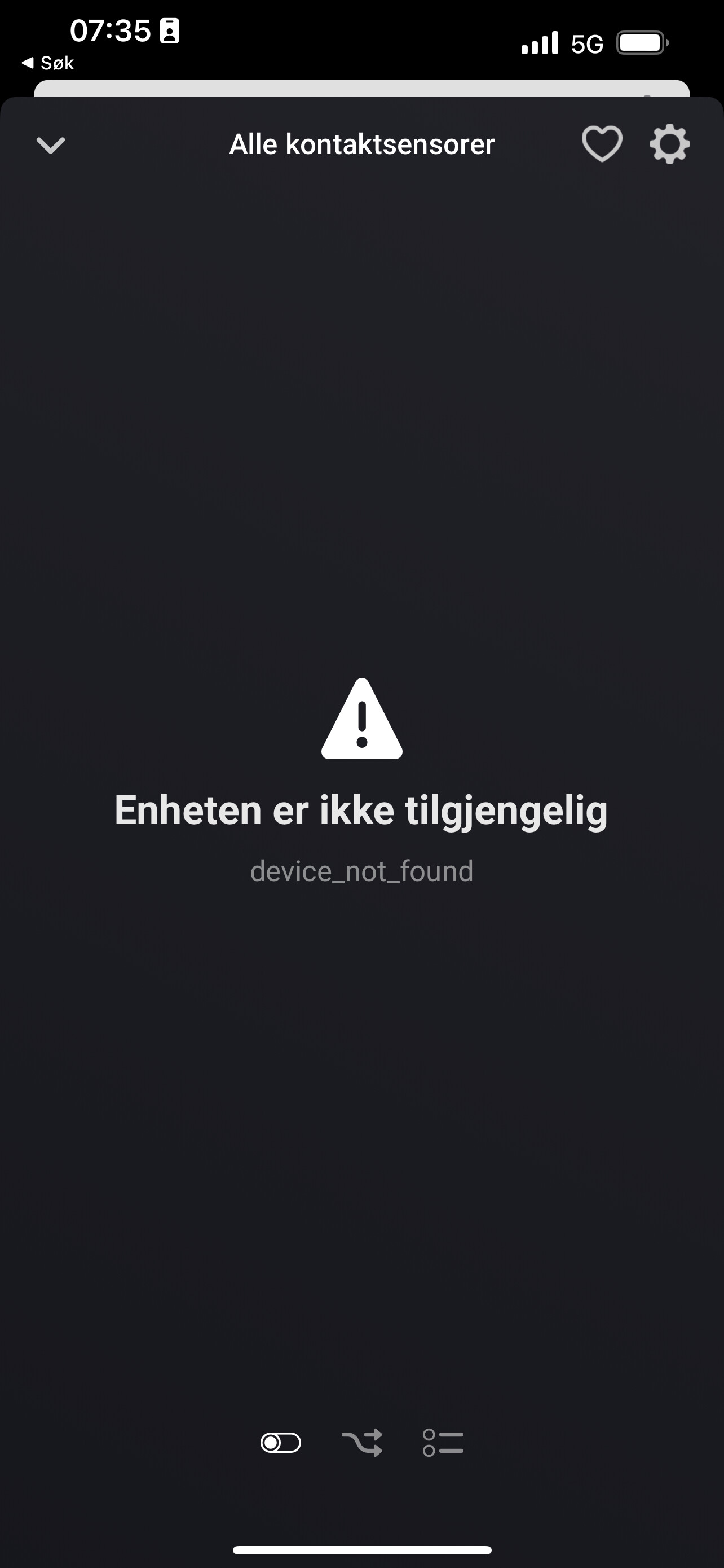

OK so it is not possible to fix the broken groups anymore?
Now several groups do not work (red triangle) anymore and other groups show incorrect data (for example average lux of a group of sensors)…

@Strauman - I would love to hear more about it failing when a device in the group is deleted, that didnt happen in the old app, ill test to see if its still occurring. I wonder if it is failing because during the migration it cant get the details of the deleted device … and so it cant migrate.
Can you please restart the app and send me a diagnostic report, including your name and the name of the device failing.

Might be something in deleted devices being a part of a group, or renamed ones…
I have an issue with groups where a device is missing but still listed in the group. Can I remove the actually non-existent devide somehow? OK, I read this will be coming back eventually.

I have released a new version of the group app,
Groups which contain devices which don’t exist … will now load. however I really don’t recommend having groups with broken device in it - its just going to slow down your group.
