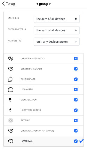

@Jamie , it looks like I have found a bug. I have a group that has no devices. I want to add a device, however when I click one of the eligible devices suddenly all are selected. So I am unable to add a device to the group. Every click does a select-all or deselect-all.
When I create a new group everything works ok… also with some other groups I have no problems.
Confirmed. But, I even didn’t know one can create a group without devices…
Now I’m a bit curious why you shouldn’t add devices while creating a group?

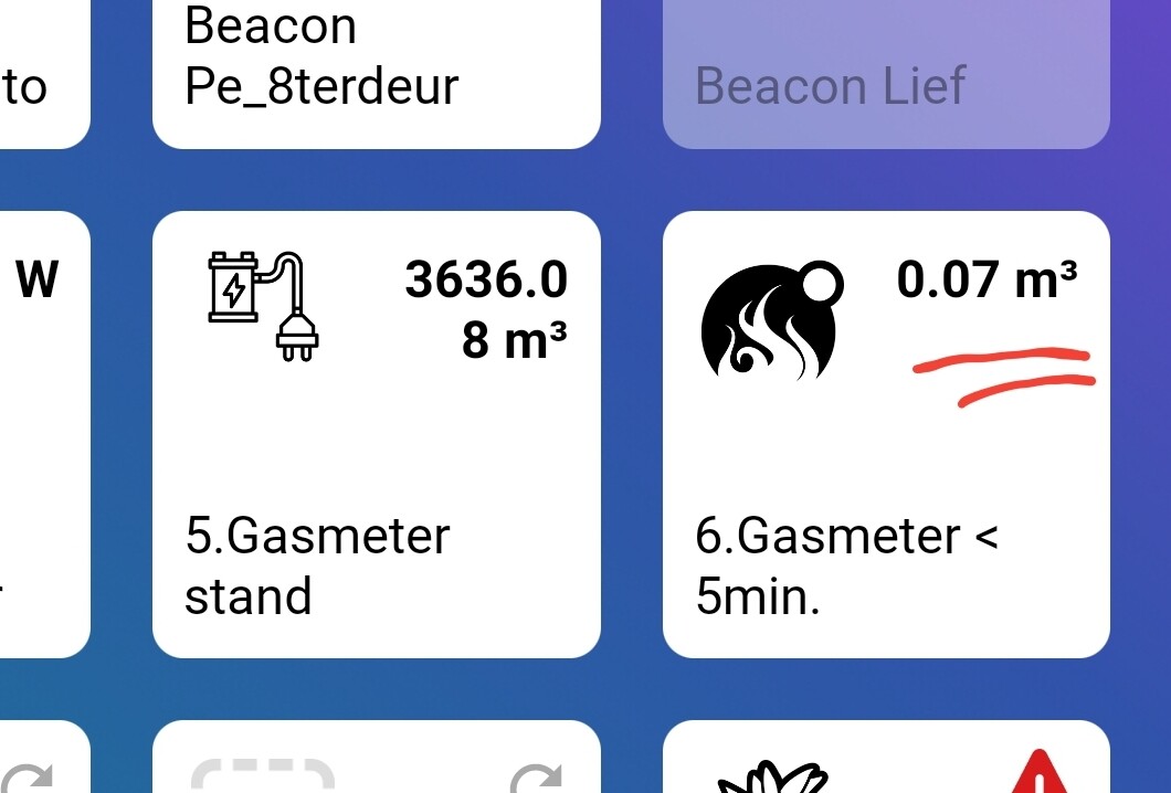

When i add a gas meter it shows only the total usage, is it possible to add the current usage?
(this would be great due to the explosion of current gas prices)
Thx.

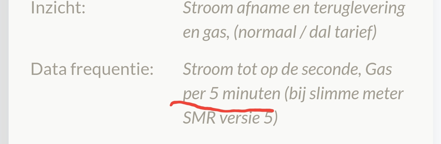

Afaik (most) gasmeters only report the total usage once every x minutes
You could create a variable f.i. [GasmeterLastValue]
With this flow, you can store the current meter value, and compare it to the one stored 5 minutes ago.
Subtract the values and feed the result to f.i. a virtual gasmeter
the actual/current usage of the gas is broadcast by the P1 meter with label ‘gas’, so there is no need for any calculations etc, the data is already present..
Ah, you’re in luck I think. Or I’m in bad luck :sweat_smile:
The HomeWizard P1 app or my energymeter doesn’t show it. Also the High/Low rate indicator isn’t here.
Running latest app v2.1.4 version
The gas flow is something I added to the energy apps I created (Plugwise Smile P1, Youless, Beeclear).
But I have good news for you: Add your Homewizard P1 to Power By The Hour. And you will get a gas flow as bonus (albeit in liter/minute) :slight_smile:
