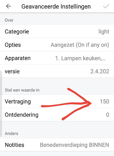

Today at a scheduled “turn off” of devices in a group one of the devices failed.
Are there any known issues that make sometimes a single device in a group to fail?
This is the app’s topic, so the dev Jamie will read your Q most probably.
Don’t know the used protocol?
In general, if many devices are switched at once, some may not receive the command. You should add a little delay, say 100ms. This delay is then applied between every individual devices’ on or off command.
