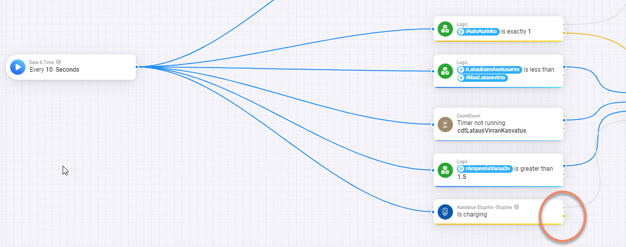

Here is one flow where I use it. Nevertheless the condition card didn’t work in any simpler flow either.

Wow, quite complex :slight_smile:

It may just be that some of the scheduled queries every 5 or 10 seconds fail. Could you add to your flow a notification to the condition card (the red line) to catch that error and log it for you.
Then again your debug report did not show such issues.
