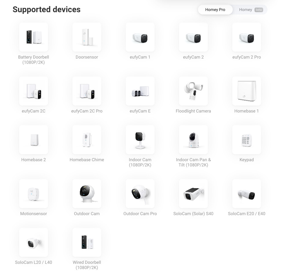

Hey Guys. Is there a possibility to add the Floodlight Cam 2 Pro to homey? After installation and setting up the app with a seperate account it is getting all the data (HUB settings etc.). But once I want to add the cams the message that no device can be found pops up.
Hey @kilofox
It’s not listed here:
So you’re actually the first with this camera.
I can add it, but it will take some time to investigate.
