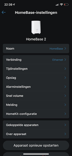

Thanks for your quick reply. I checked all settings but can’t seem to find the right ones:
Have to do it in multiple posts… sorry…
Here all the settings are right:
@Justin_M
Hmm that seems right.
Can you send a diagnostic report?
More → apps → eufy Security. → settings wheel > send diagnostic report

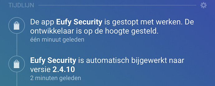

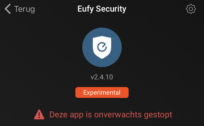

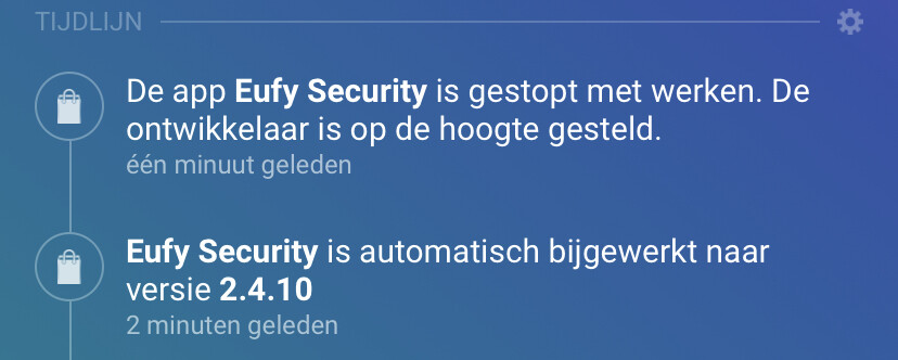

New app update (test: 2.4.12 ):
Changes:
  • FIX: wired doorbell on/off + quickResponses
EDIT: There was a small bug in 2.4.10. Fixed in 2.4.12
@martijnpoppen “Houston, we got a problem”
Edit: Nevermind… You already changed your otiginal message :wink:
Yep sorry!
Made some changes but forgot to add the new file :see_no_evil:
Luckily it’s only the test version :stuck_out_tongue:

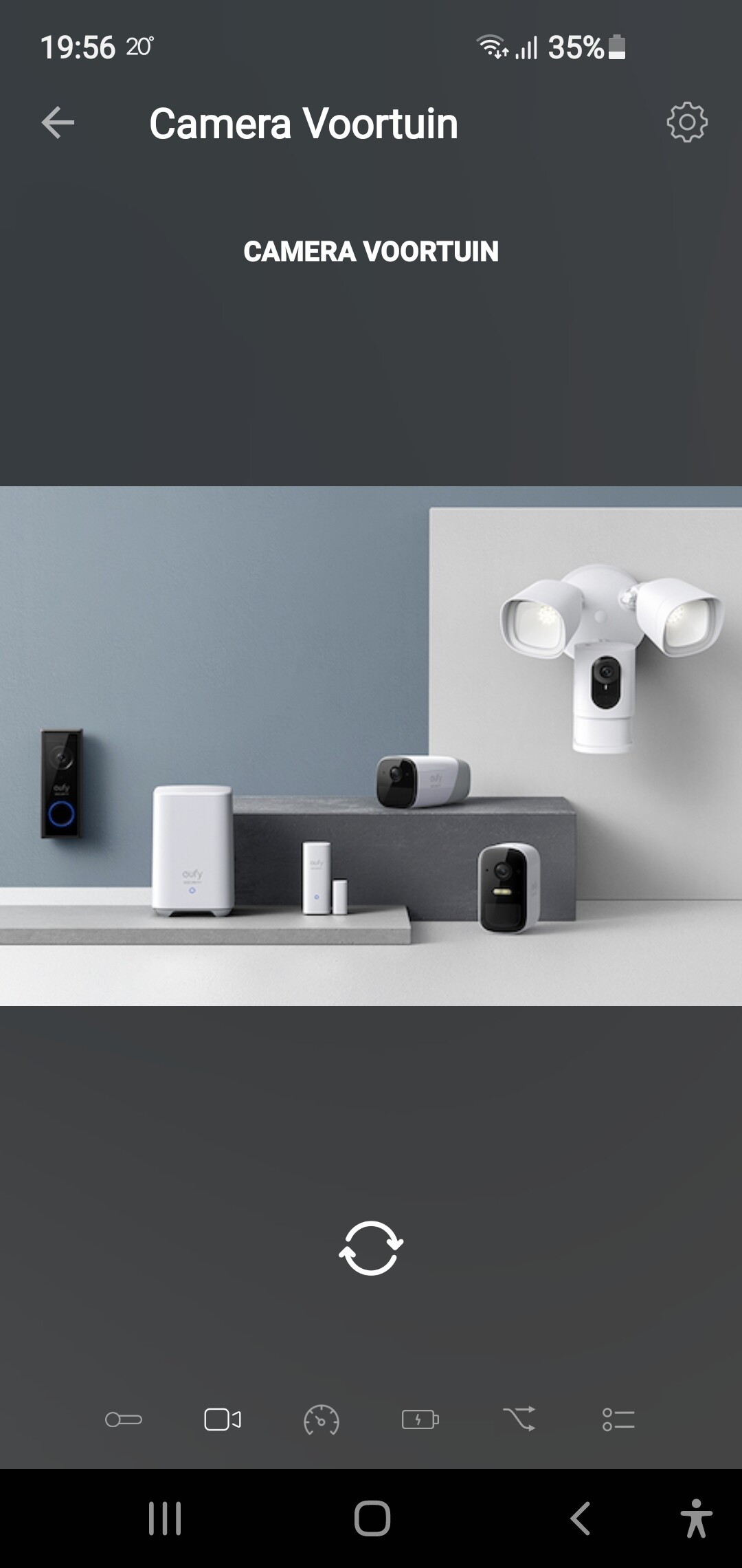

Not sure if this was already fixed or is on the todo list but I still see no images on my 2c pro cam in homey. All I see is the eufy image.
Restarting the app doesn’t help. No pronlem with the originsl eufy app.
@Heula do you have notifications enabled for motions/person detection? Only when a event happens the image gets updated.
Yes they are enabled. Until one of the last updates when it is forced to be enabled I often checked if the were enabled.
I have this for some time now and it have worked before because I use pipup and there I saw images of this cam and my doorbell.
